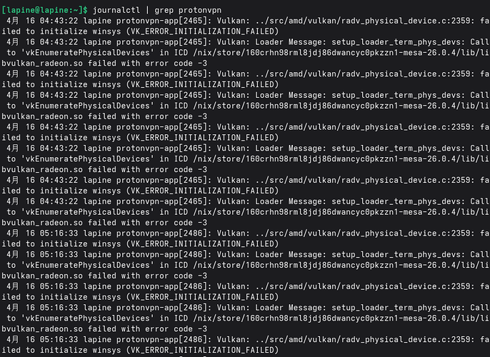

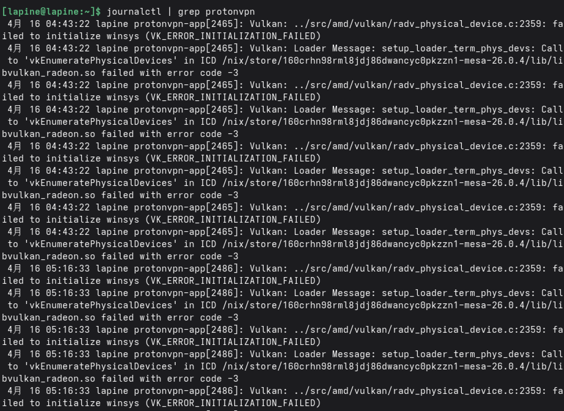

The protonVPN app refuses to log in, here’s the journalctl:

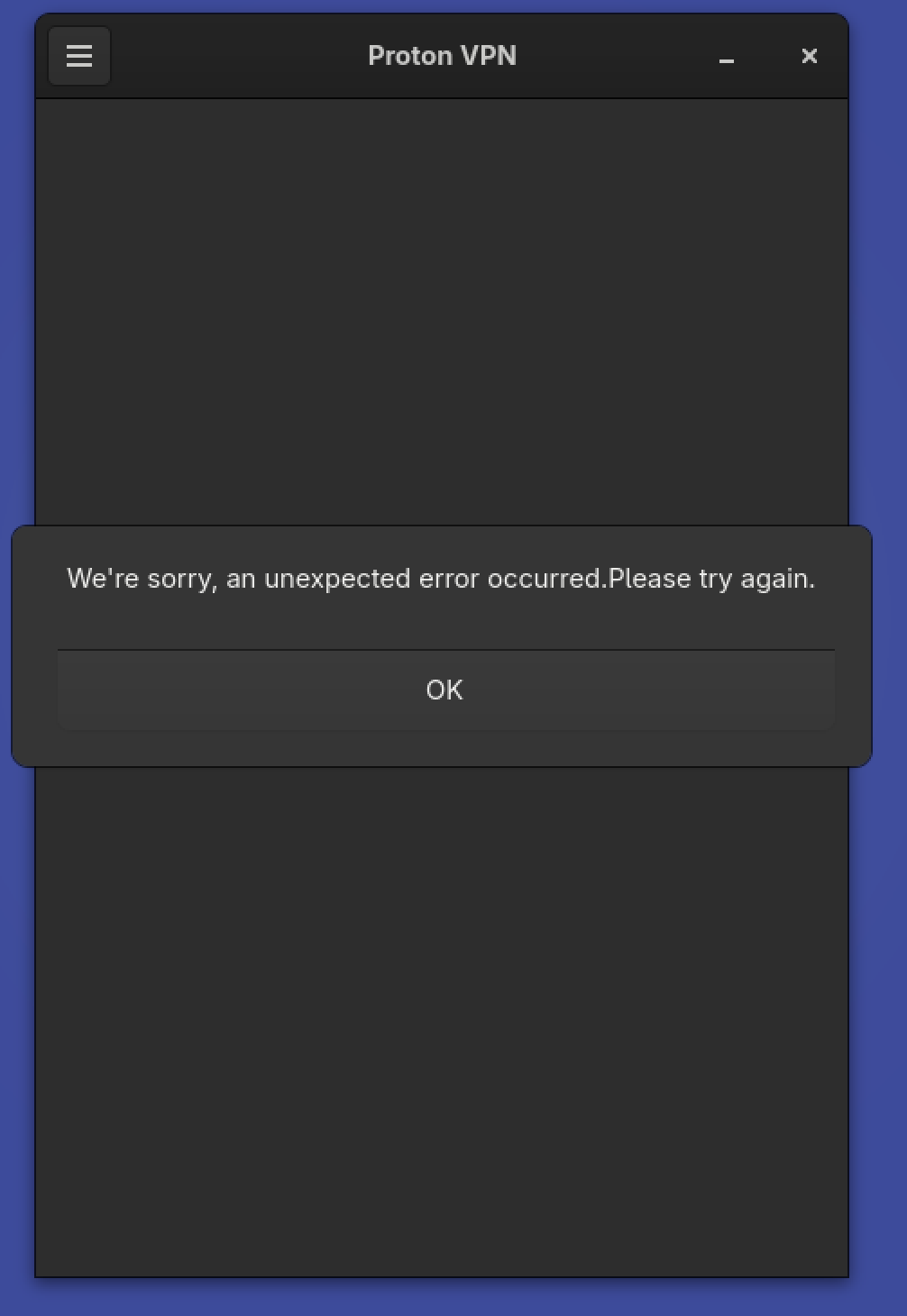

The app launches, but trying to log in tells you “an error occurred”, unsure if these errors are related.
rebooted and it DID log in, but the interface is blank and launches like this
Unfortunately its hard to tell from that error alone. It seems to be a VK_ERROR_INITIALIZATION_FAILED in vkEnumeratePhysicalDevices, and the Vulkan docs aren’t helpful here as they don’t explain when this might happen…
Will have a further look.

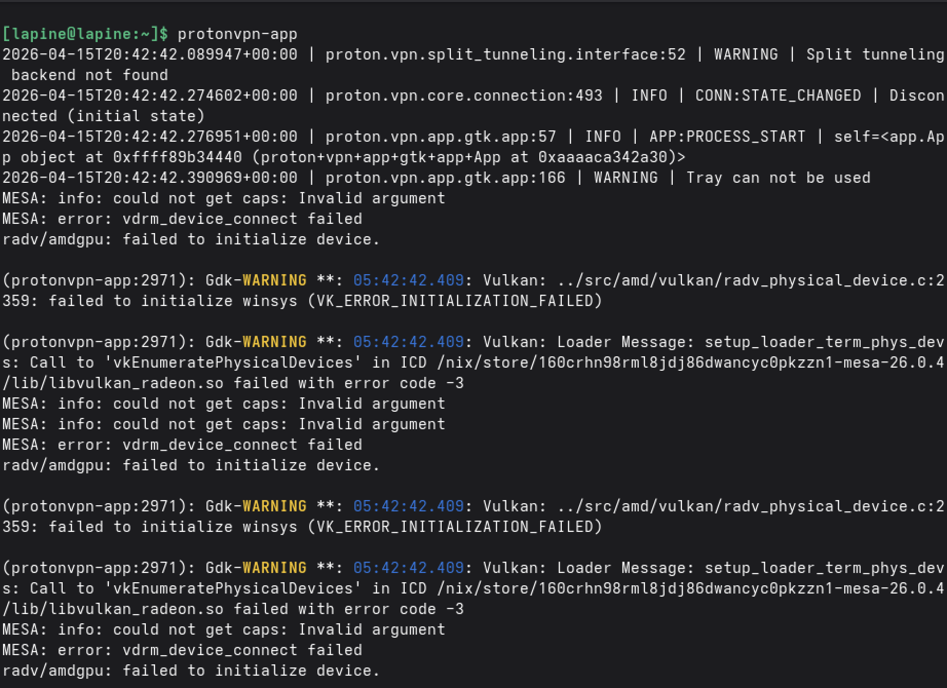

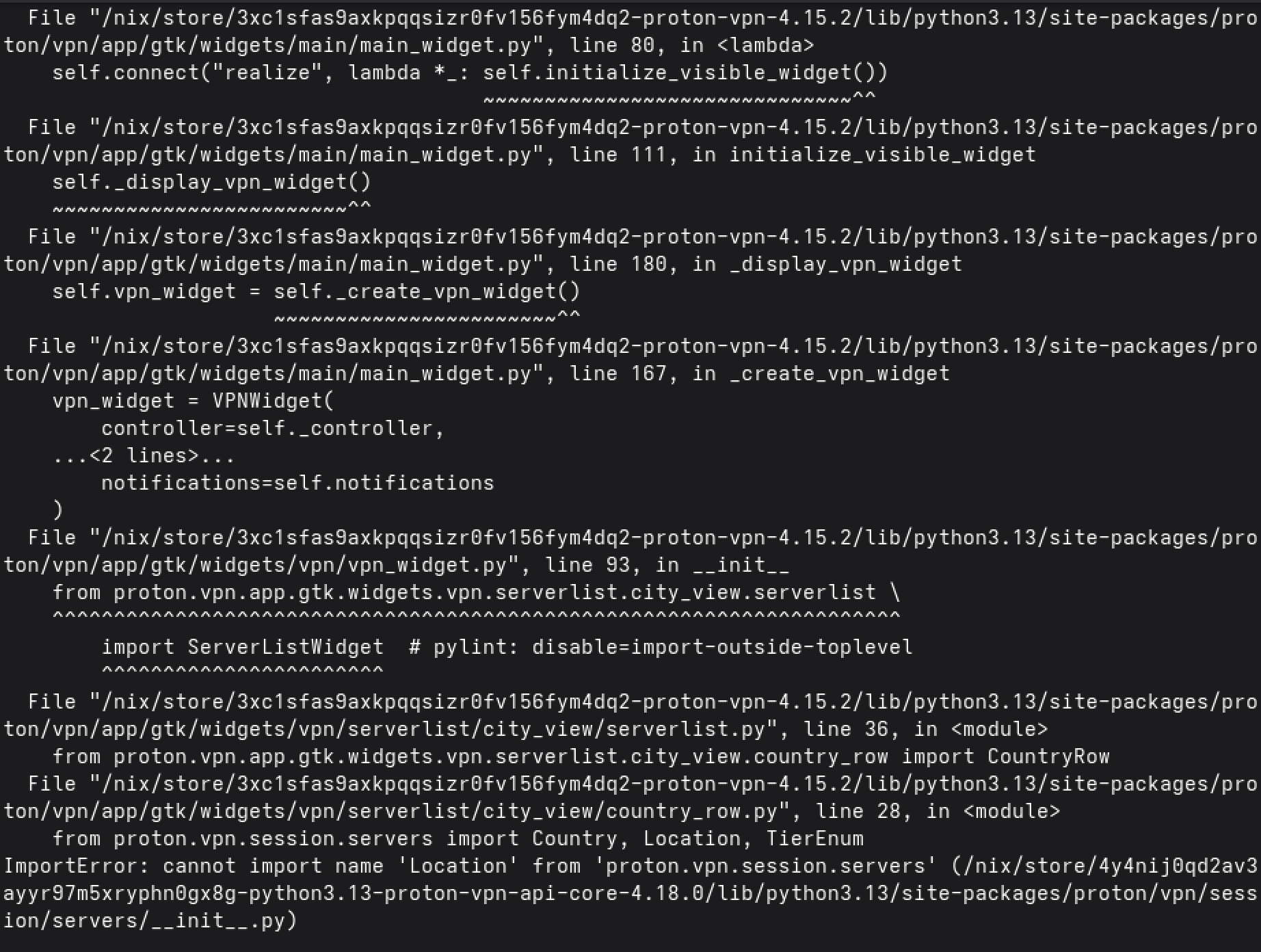

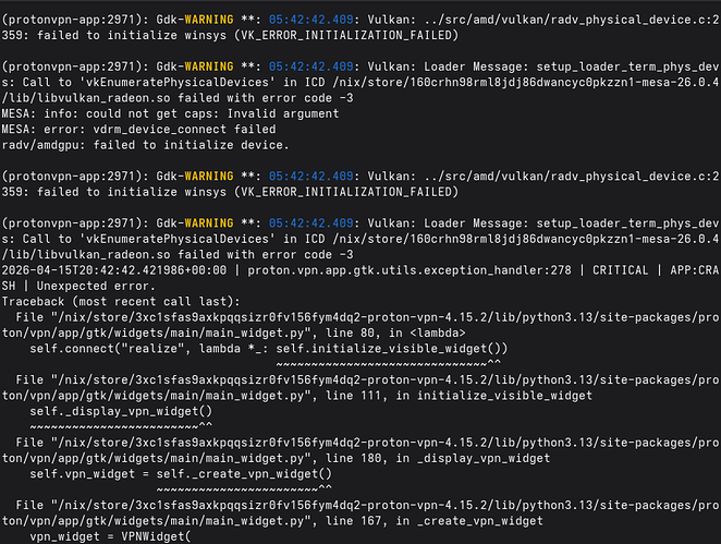

Thank you so much for the help, yes, found some other errors by doing that! Here they are:
I think your error might be related to this issue, the logs look similar.
This looks like a packaging bug?
Looks like: proton-vpn: 4.15.2 is built against incompatible proton-vpn-api-core · Issue #509185 · NixOS/nixpkgs · GitHub
