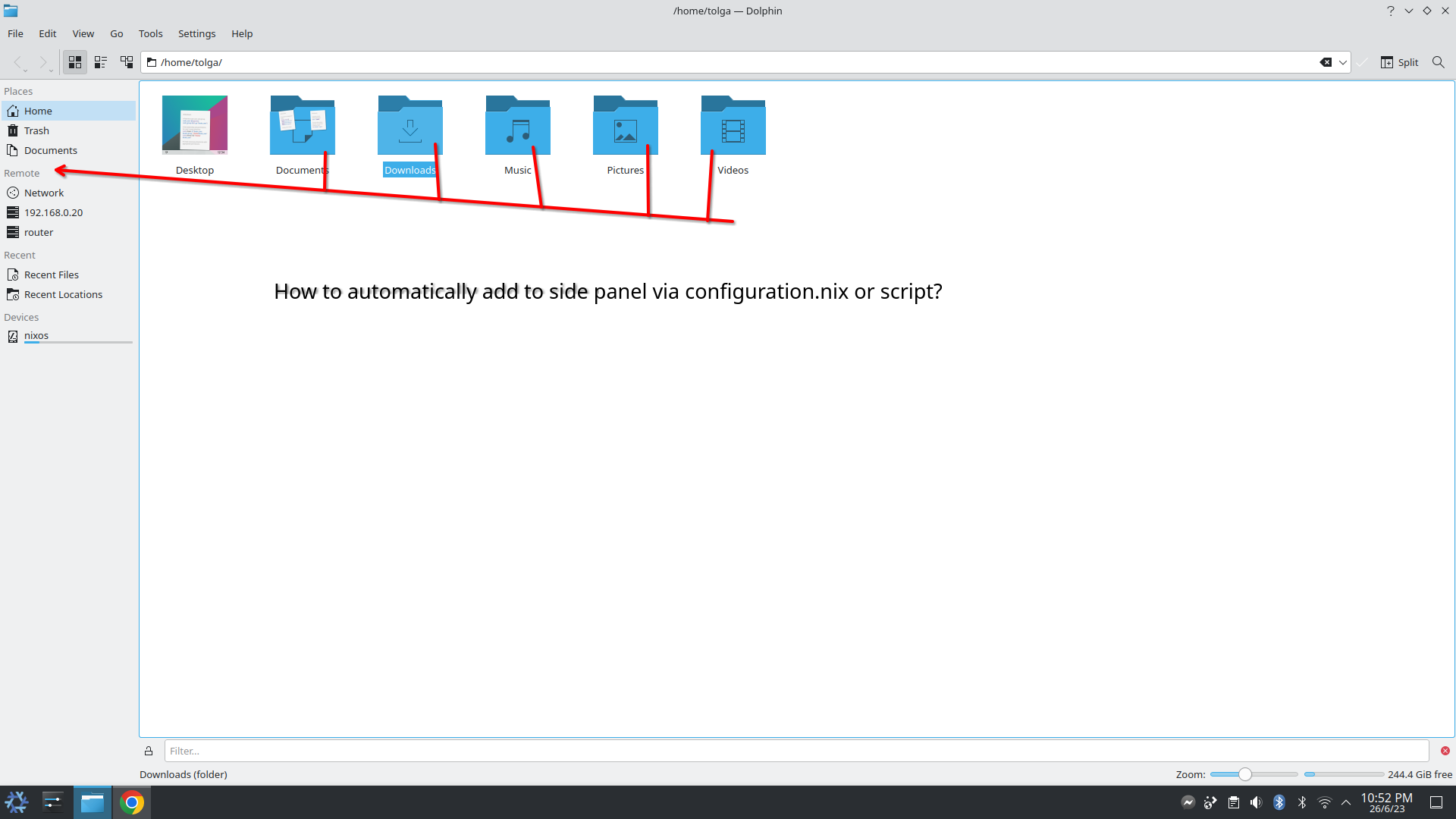

Automate to add users home folders into dolphin side panel
Hello all
How would I go about automating the process of adding the users’ common folders to the Dolphin side panel?
Do you use some initial snippet inside the configuration.nix file or a script to accomplish this?
Any assistance would be greatly appreciated.
thanks
