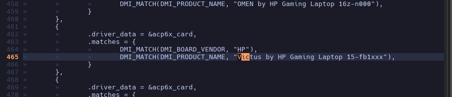

Best way to compile a kernel with custom options in Nixos
Fixing HP Victus 15 internal microphone drivers by compiling patched auto-updating kernel with Nixos

i need an solution for this problem
with this change i need to patch my kernel
