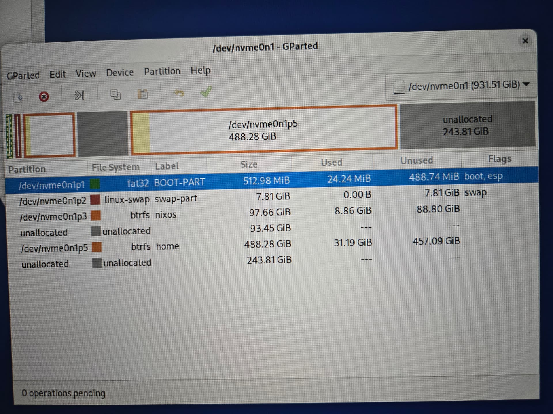

Not sure if this is the cause of the issue or if it is even relevant, but when choosing the disk to install on, I manually created the partitions. I previously had installed Fedora 41, but I deleted all of it and only left the home partition.
I also tried using separate partitions for /boot (512 MiB) and /boot/efi (500 MiB) but got the same results.

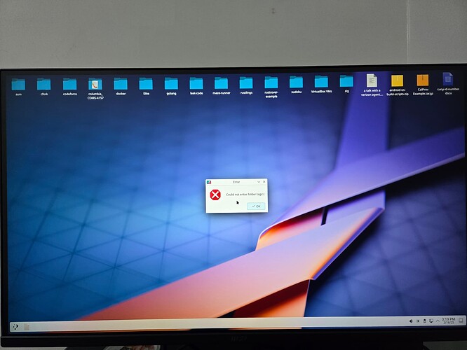

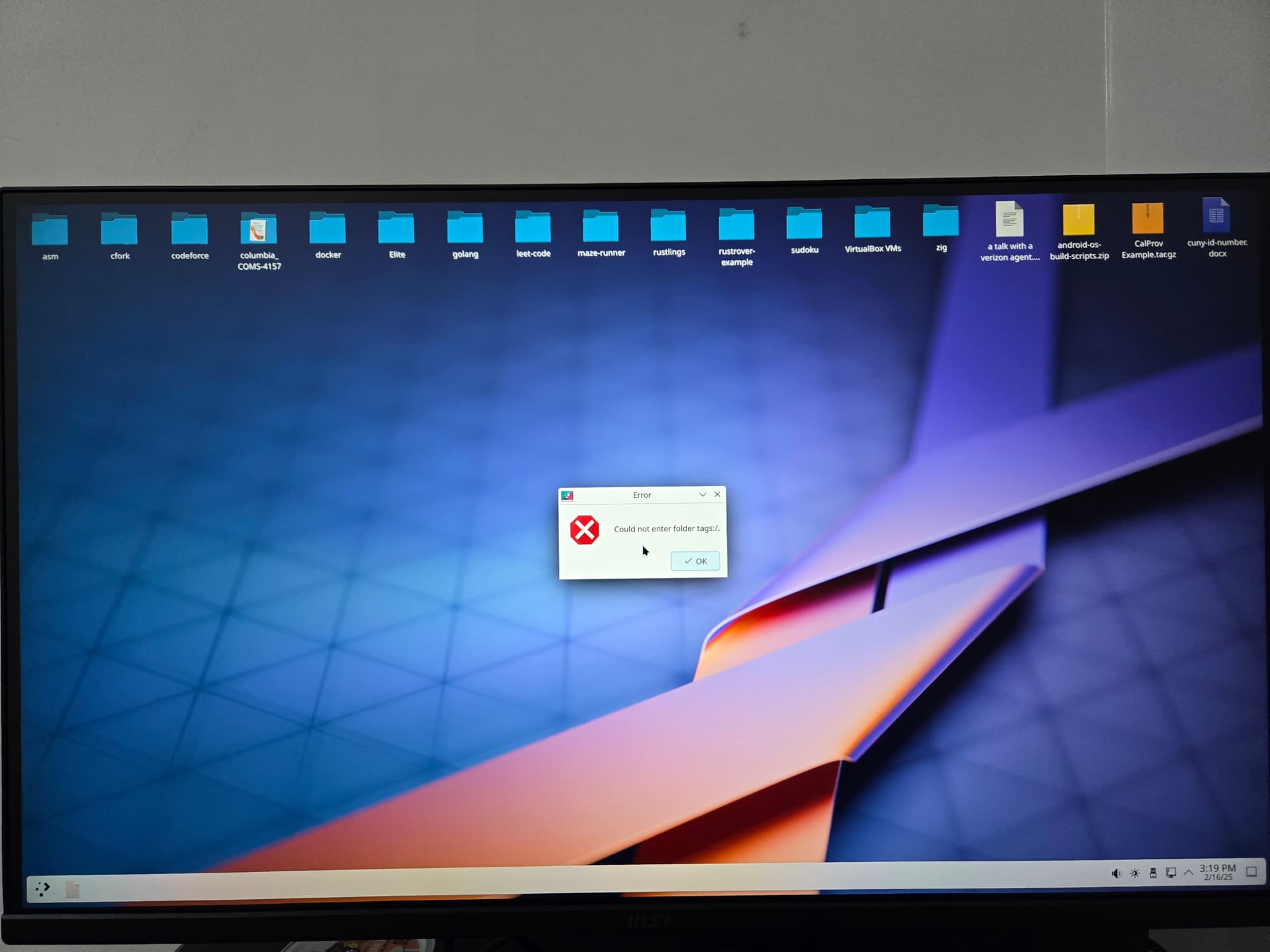

Then I let it install the OS and rebooted. It boots to the Plasma SDDM and everything looks normal, but when I log in to my user I see this:
I tried opening the terminal but there are no applications. clicking the system tray lets me configure WiFi and everything else that is present in the tray.

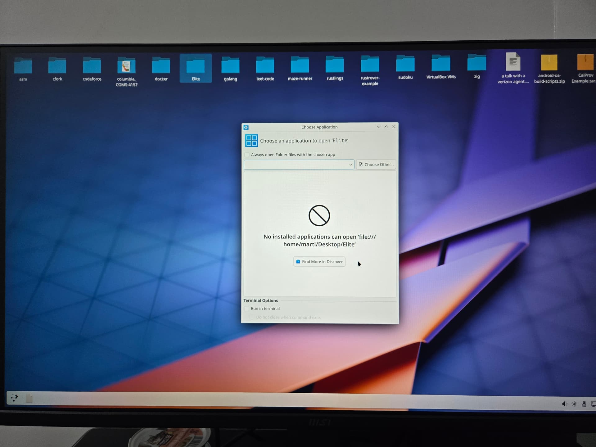

Trying to open the Desktop files shows this:
From this window I can click “Choose other...” to show a file picker, and from there I can open Dolphin. I saw that everything was there in the my home directory, but on root there were clearly a lot of things missing. E.g. /usr only had one file /usr/bin/env.

I did have Fedora with Plasma, so that’s probably it. Also later on I notices that on the Gnome install the home partition wasn’t actually mounted. I’m going to delete the home partition and create an empty one since I have a backup with all the files I wanted to keep, and copy the backup to the new home.
