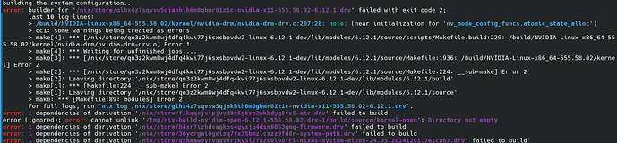

Builder for nvidia-x11-550.78-6.10.drv failed with exit code 2
That’s very odd, since you add that explicitly to environment.systemPackages, so it should be there whether the nvidia module is added to your system or not. Just to double check, you didn’t comment this out, right:
If you did, that’d explain why both of those are missing, given you special case on it for adding nvidia-settings.
I removed the comment on that, but now there’s an error I haven’t seen yet:

Trying 560 driver with overrideAttrs commented out yields:
error: builder for '/nix/store/y68lmsz4wwlv6sy4gwkknq3l3n94f4yc-nvidia-settings-560.35.03.drv' failed with exit code 2;
       last 10 log lines:
       > make[1]: *** [Makefile:381: _out/Linux_x86_64/gtk3/ctkevent.o] Error 1
       > In file included from gtk+-2.x/ctkwindow.h:25,
       >                  from gtk+-2.x/ctkwindow.c:34:
       > libXNVCtrlAttributes/NvCtrlAttributes.h:24:10: fatal error: vulkan/vulkan.h: No such file or directory
       >    24 | #include <vulkan/vulkan.h>
       > compilation terminated.
       > make[1]: *** [Makefile:381: _out/Linux_x86_64/gtk3/ctkwindow.o] Error 1
       > make[1]: Leaving directory '/build/source/src'
       > make: *** [Makefile:23: all] Error 2
       For full logs, run 'nix log /nix/store/y68lmsz4wwlv6sy4gwkknq3l3n94f4yc-nvidia-settings-560.35.03.drv'.
error: 1 dependencies of derivation '/nix/store/gii45ixirbr6a3hikvj1fy0xs5q7g5i2-unit-coolercontrold.service.drv' failed to build
error: 1 dependencies of derivation '/nix/store/29lv61ns2bbsji3xycj4adkcpgf4vvmj-system-units.drv' failed to build
error: 1 dependencies of derivation '/nix/store/by53vxfb32gja4n26aipipi29bql807s-etc.drv' failed to build
error: 1 dependencies of derivation '/nix/store/x4x3dycz9s268vn6d5l2f4zb7mdvrlvn-nixos-system-nixos-24.05.20241004.6e6b3dd.drv' failed to build
Hello again, I’m returning with another error since vulkan header is still not implemented but the same 555.58.02 driver I’ve been using for a while is giving me this
I tried a newer driver hoping that the Vulkan header problem is already fixed but of course it’s not.
