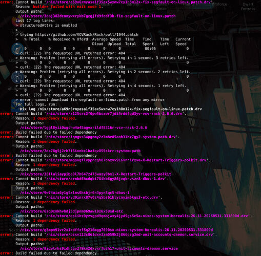

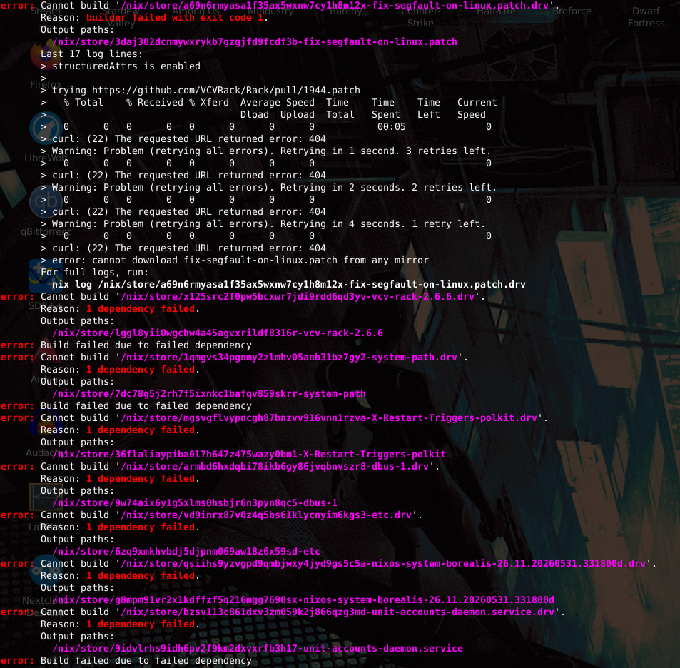

Building error, issue with url?
I would appreciate your help. Is this temporary issue with packages or should I fix something on my own?
It looks like the upstream has disabled pull requests and/or deleted those that existed.
This will need to be fixed in nixpkgs.
so should I wait for the fix?
I would open an issue on the nixpkgs GitHub to make the maintainers aware, as an issue for this issue does not appear to exist.
Edit: Removed advice to extract the patch from the store as the PR to fix it has the original commit.
thanks, I would appreciate that
By “I would open an issue” they weren’t offering to do it themselves, they were saying you should do it.
Issue created:
FYI: A PR addressing this has been created
