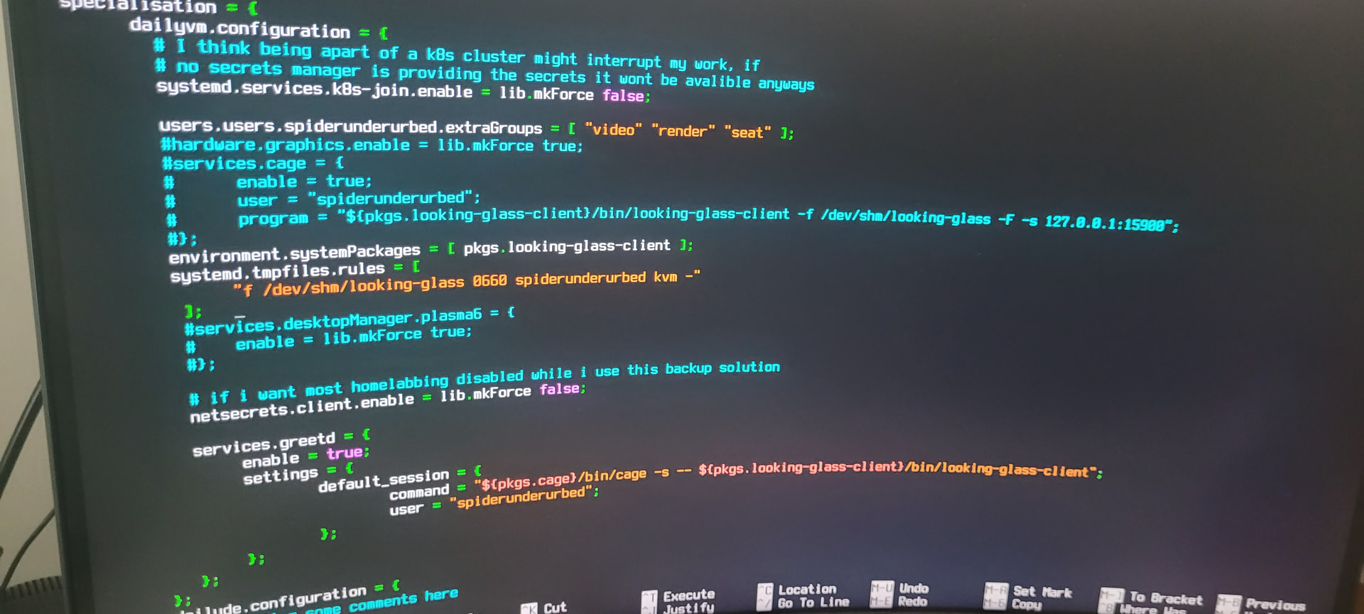

I am trying to get greetd to start up cage with an application immediately ready to display, however it is complaining it lacks the graphics libraries

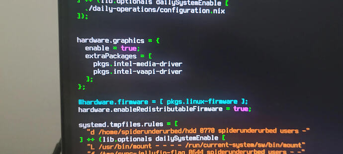

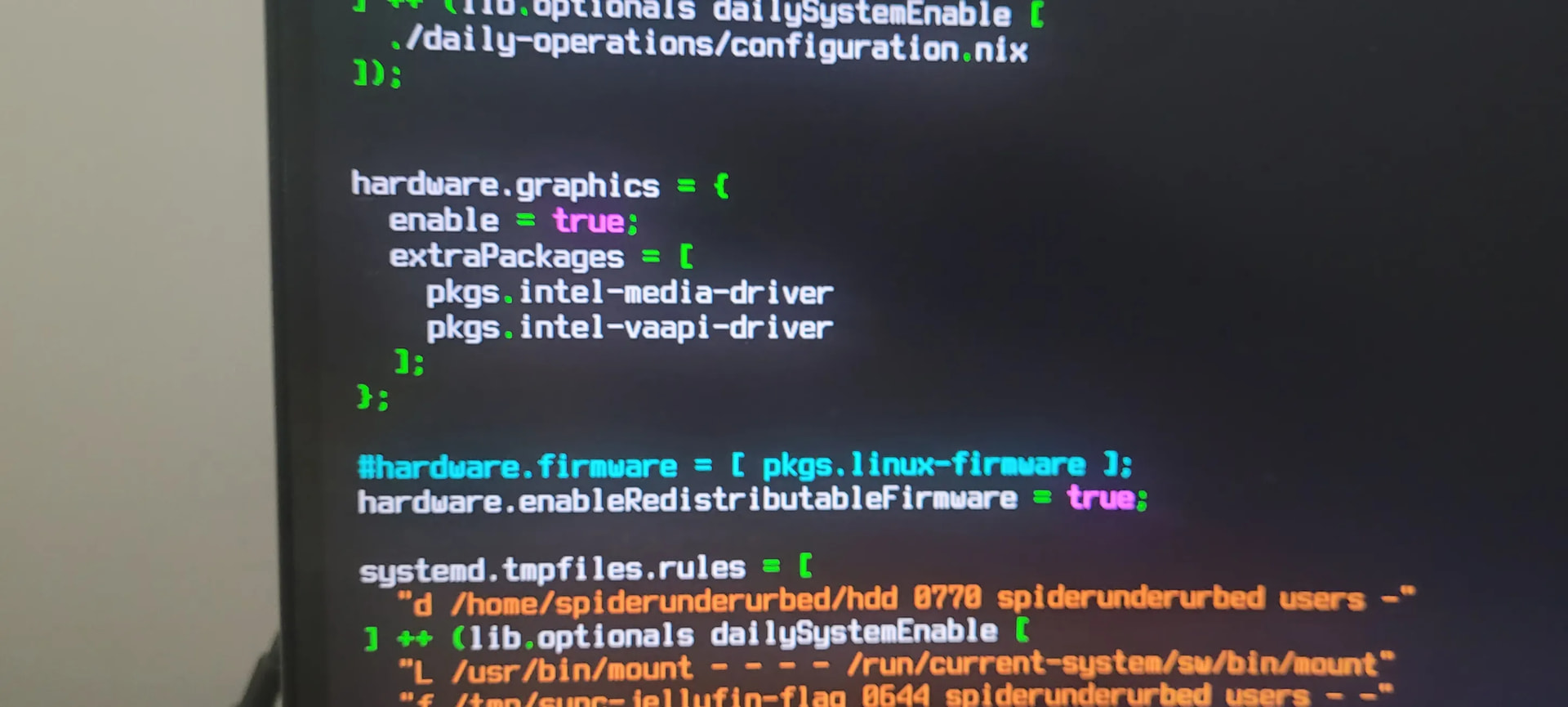

With this config:
Also I saw the posts about enabling hardware.graphics and that was one of the first things i did (I tried this on the base system and the specialisation)
