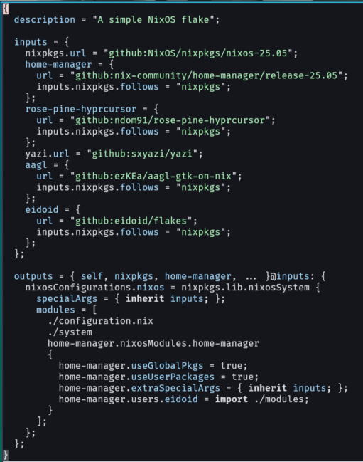

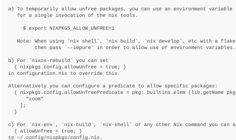

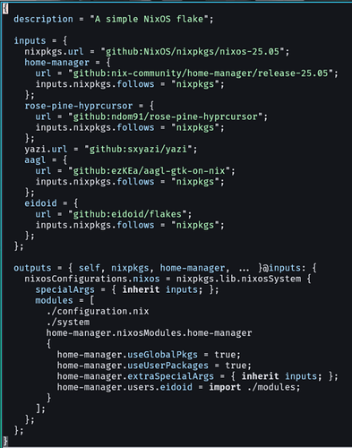

I’m trying to install an unfree package from a remote flake repository, this is my flake configuration However, when I’m trying to install a unfree package from a flake input, it show the error in the picture. I’ve add nixpkgs.config.allowUnfree in my configuration.nix and I can:

I can not install a package like this home.packages = [ inputs.someguy.packages.${pkgs.system}.someunfreepackage ] Your time and help is greatly appreciated.

Hmm, I think using nixpkgs-unfree is a relatively clean solution.
Something like:
inputs = {
  nixpkgs.url = "github:NixOS/nixpkgs/nixos-25.05";
  nixpkgs-unfree = {
    url = "github:numtide/nixpkgs-unfree";
  eidoid = {
    url = "github:eidoid/flakes";
    inputs.nixpkgs.follows = "nixpkgs-unfree";

Could you give me more detail about the overlay thing please? Because I think the upstream (which is me) don’t know how.
Sadly this method gives me the same error for some reason.
