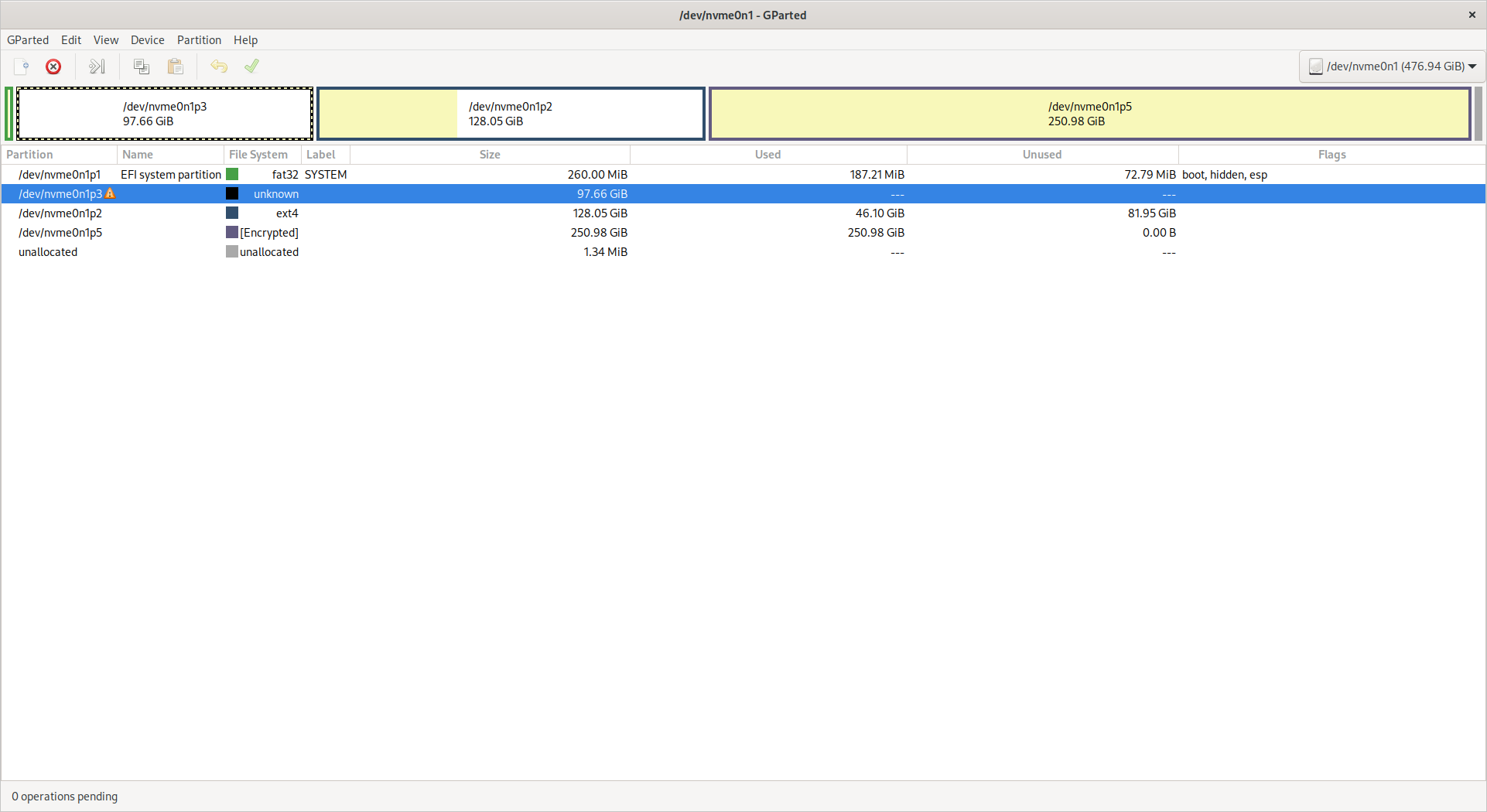

Here is my current disk layout:
I would like to install it in the /dev/nvme0n1p3 partition.

You have an esp, why do you want to install legacy boot cruft into the MBR a partition? Even if the disk is not GPT, a partition doesn’t have an MBR… It’s per disk.
Just use EFI. Perhaps a second ESP, to make sure nothing clashes.
You’re trying to create a partition table on a partition instead of a device - that’s why you get the weird error.
Just create the file system instead, since you already have a partition table (and a partition). But, like @NobbZ says: make sure you’re using EFI (and boot the installer in EFI mode).
Though, I would not create a second ESP to avoid confusing firmware/bootloaders - rather, as p3 is still unused, delete it and expand your current ESP to ~512MB so you don’t run into space issues.
