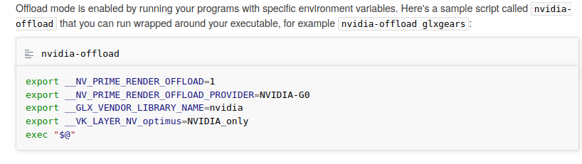

Another thing is that this is my first contact with scripts, and I don’t understand some of the terminology and don’t know of some steps implied. Reading this on the wiki:
What does “wrapping a script around an executable” mean? I am pretty sure the code has to be inserted into a file, but which one? Given the example script, how do I know which parts are to be altered for my programs and in what way?
In this case the author probably meant "execute the given executable by giving it as an argument to nvidia-offload.
nvidia-offload, which I believe is created automatically for you these days (might need to enable that if you have not yet). The wiki is - as usual - outdated.
You should be able to use nvidia-offload for all programs. For example, nvidia-offload steam in your console should just work.
I have it enabled, but have no idea how to use it. It says that hardware.nvidia.prime.offload.enableOffloadCmd “[a]dds a nvidia-offload convenience script to environment.systemPackages”. Is environment.systemPackages the entry in configuration.nix or a directory? If it’s a directory, how do I access it?

The option. Setting that other option already added nvidia-offload to it; you don’t need to do anything else with it. As I said, the wiki is outdated.
It will put the nvidia-offload script in the $PATH env variable, and since doing the launch options thing is working it’s already there and everything is set up correctly.

Thank you for clarifying that it’s set up correctly. I would still like to ask a question to get a better understanding.
The option. Setting that other option already added nvidia-offload to it; you don’t need to do anything else with it. […]
The option in configuration.nix stays the same. Does the option exist somewhere else where the change in it occurs?

Here: https://github.com/NixOS/nixpkgs/blob/32dcb45f66c0487e92db8303a798ebc548cadedc/nixos/modules/hardware/video/nvidia.nix#L398
And a lot of other places where different changes occur :slight_smile:
All declarations of nixpkgs options are merged together when you evaluate your configuration, including ones hidden in nixpkgs. For lists, all of the instances will be concatenated together, other options may give you errors telling you to use lib.mkForce to override them. Often when you use a *.enable option the module being enabled will set environment.systemPackages to include its package, and do some other miscellaneous setup (like add systemd units, configuration files, …), all using other, less abstract options defined in nixpkgs.
This goes on recursively until you arrive at the “activation script”, which is a big bash script that makes all the changes the various options imply, and is run every time you run nixos-rebuild switch or boot the system.
Note that the actual options are of course not literally written out in a merged form to a file you can read. This happens all in memory, when nix evaluates the modules, and is completely transparent to you. The closest you can get to seeing this behavior is using the lib.debug.trace* functions.
You can get this merge behavior and split your own configuration.nix into multiple files using imports, by the way.
If all it does is to set some env vars, you could add those to steam and its children via programs.steam.package.
