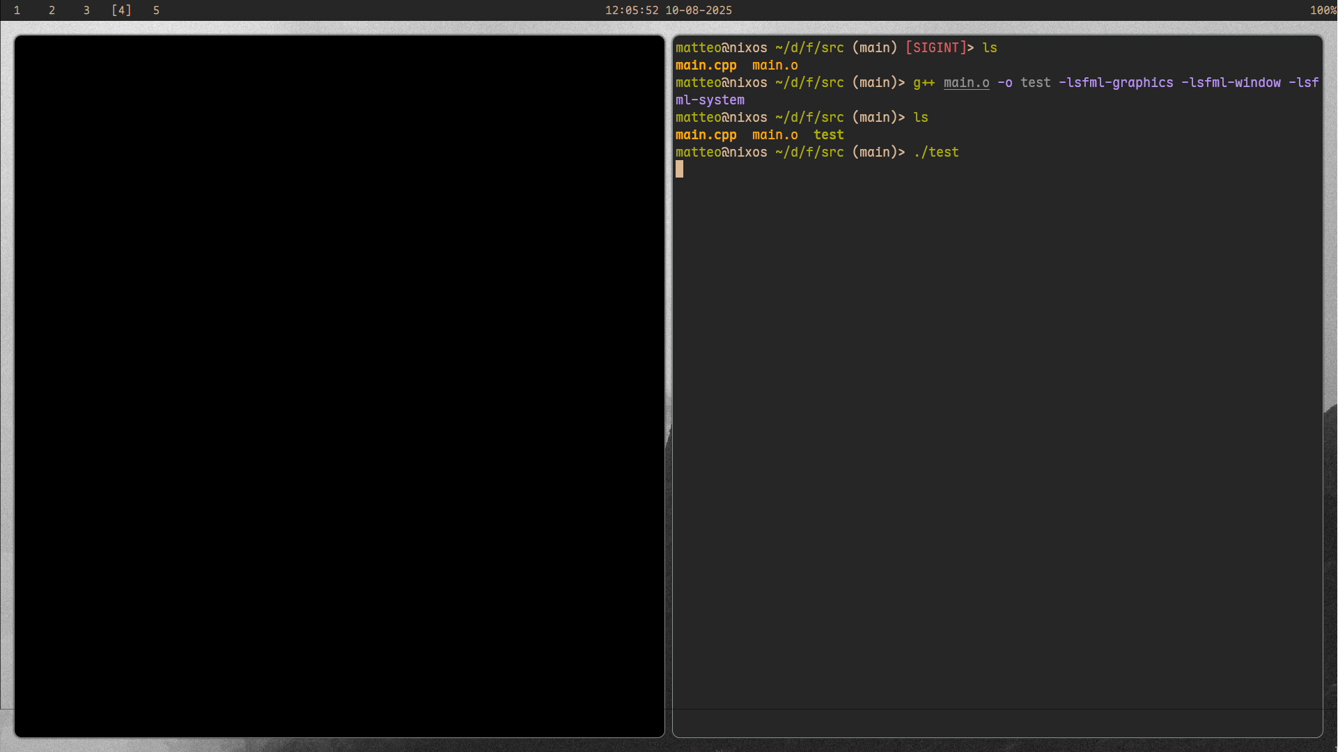

I also started using sfml and c++ today and I think you need to run the following to only compile it to a object file (main.o) because sfml is not linked by default when you try g++ main.cpp
g++ -c main.cpp
Now Link it to provided sfml libraries to get the final exectuable sfml-app:
g++ main.o -o sfml-app -lsfml-graphics -lsfml-window -lsfml-system
If you execute it now you will get the desired window:
./sfml-app
With your code nothing happens, because you are not actually displaying anything, to try it out use this instead:
#include <SFML/Graphics.hpp>
int main()
    sf::RenderWindow window(sf::VideoMode({800, 600}), "My window");
    while (window.isOpen())
        while (const std::optional event = window.pollEvent())
            if (event->is<sf::Event::Closed>())
                window.close();
        window.clear();
        window.display();
After compiling, linking and running the executable, we get this window:
