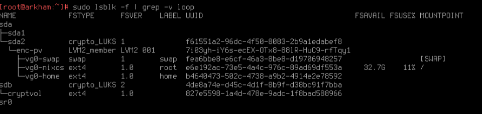

UUID returned by blkid /dev/sdb is 4de8a74e-d45c-4d1f-8b9f-d38bc91f7bba, but perhaps this is the other UUID after mounting crypted vol ?

Here the list of uuid :
