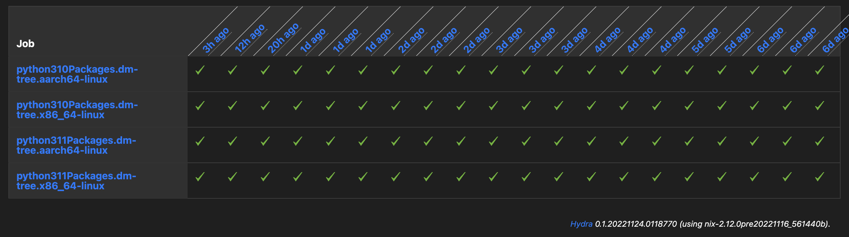

Hmm looks like the builds should be working fine. What commit of nixpkgs are you on?
Ah, ok. My system is 22.11.20230410.115a96e (Raccoon), but the flake is pulling from the unstable url. I’m using poetry2nix to build a development environment, and poetry seems to put together the lock file with no problem, but then when I try to “mkPoetryEnv” the build fails with dm-tree looking for cmake.
I’m not familiar with poetry2nix… have you tried simply using python3Packages.dm-tree?
Thanks for your help! I went through some rounds of trying successive overlays to provide the required build dependencies for packages in poetry2nix, but in the end I couldn’t get cmake working for dm-tree. Based on your comment above, I ended up just installing python with a few packages and then installing all the ML libraries in a virtual environment simply with pip. It’s a lot of packages in a requirements.txt. Here’s the flake.nix I used in the end:
