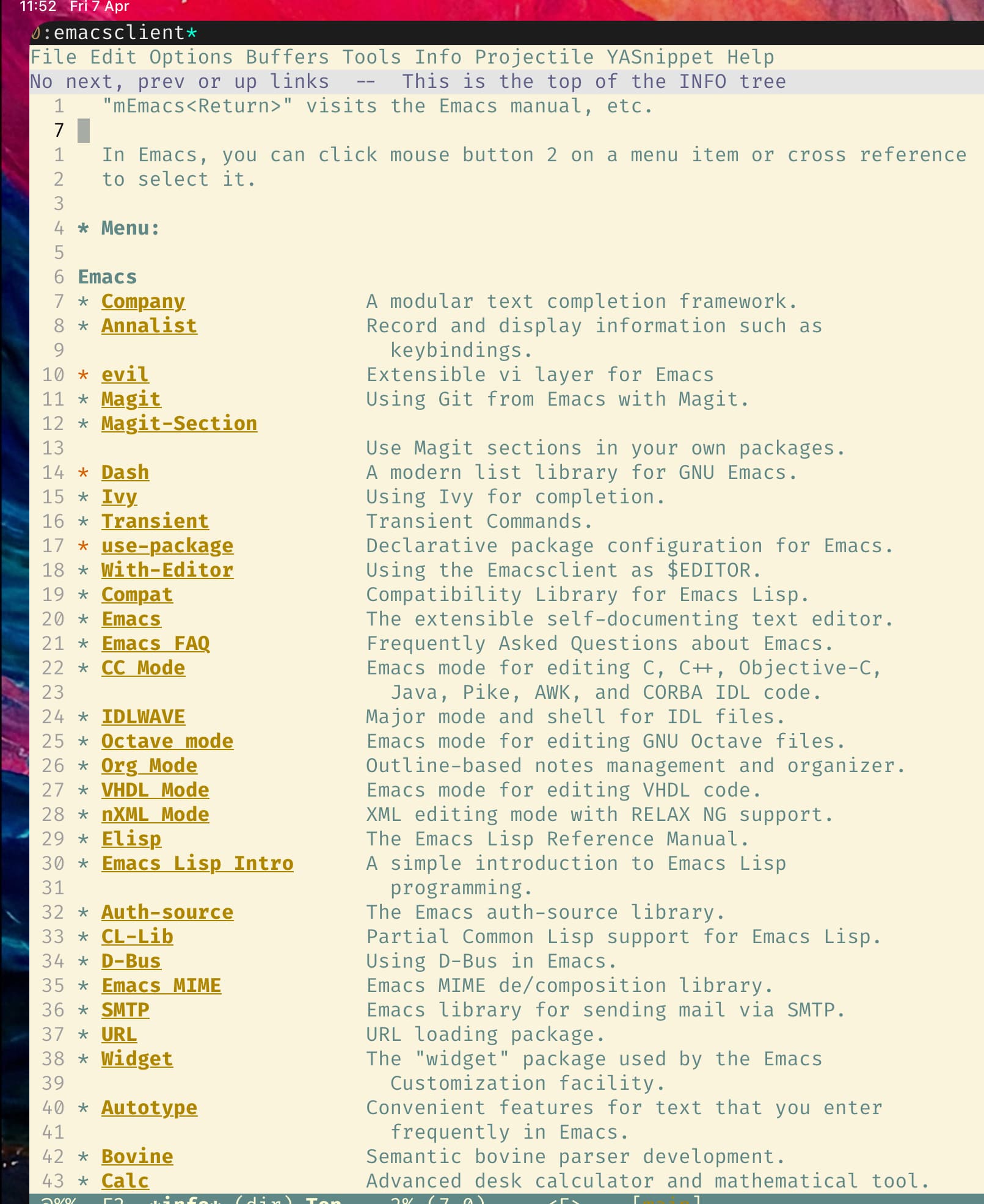

Hi, not exactly. That is the Emacs manual which I can still get to from C-h r. I figured out that this is actually still installed (but not in the expected way) after I made the original post. Sorry for the confusion. I’m talking about the Info Directory node (press d in an Info mode buffer) which lists all the Info files installed on your system. I’m pretty sure on another distro this listed the Emacs and Elisp docs, but now my “Emacs” section of the directory only has Info pages for packages I’ve installed, but not Emacs itself, if that makes sense.
Here is an example I’ve found of someone else’s Emacs:
https://oremacs.com/download/hydra-info-dispatch.png
Under the Emacs section, mine is missing the Elisp, Emacs Lisp Intro, Emacs, and Emacs FAQ docs, and only has the specific package docs (for example, something like AUCTeX in this picture).
