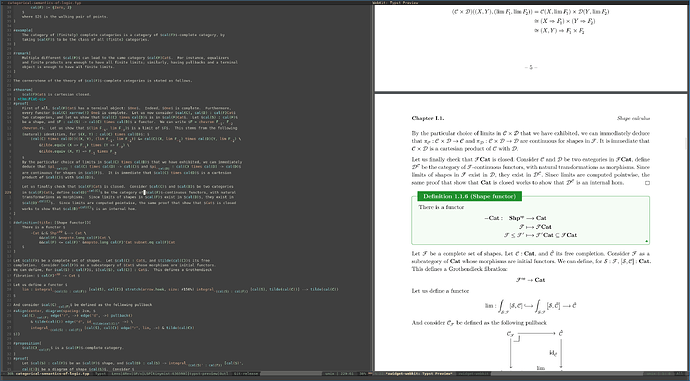

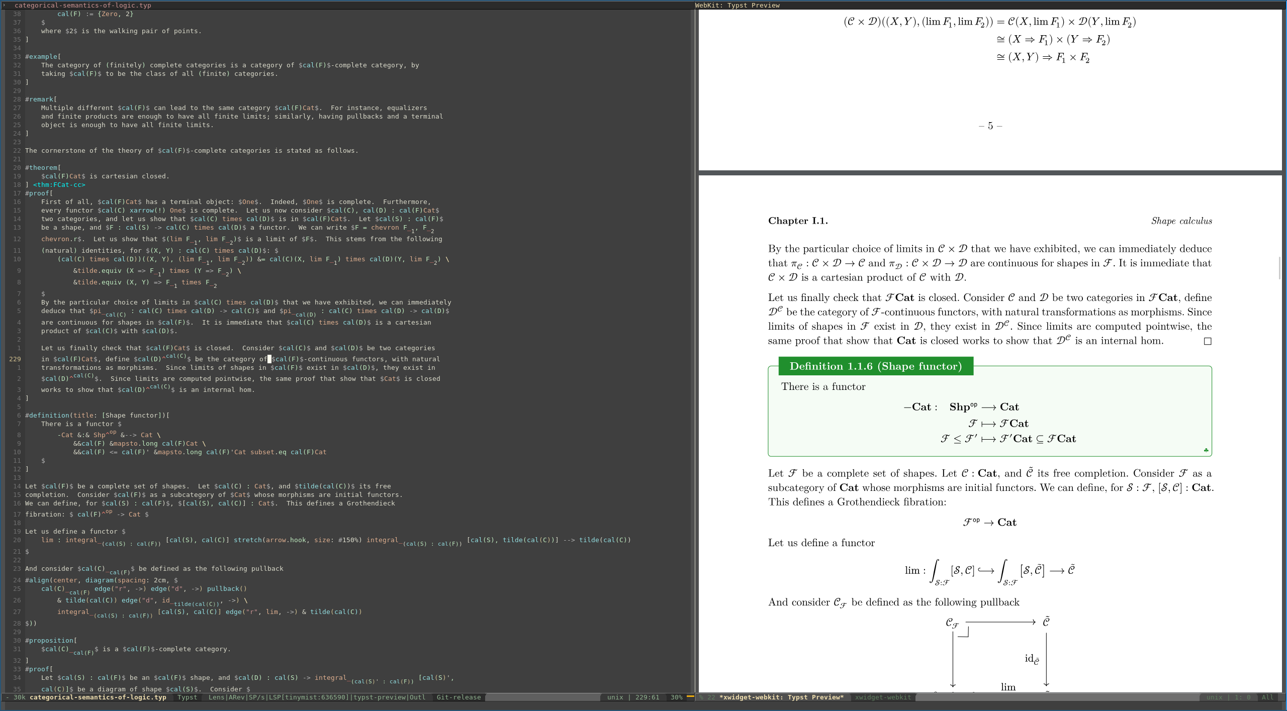

However, recently upstream Emacs has re-enabled webkit2gtk above the threshold version, fixing the crashes. Hence, I think there is no reason to hold back the xwidgets feature. As a proof of concept, I have built the latest emacs (using the emacs overlay), with the xwidgets feature turned on and the broken flag overridden. Here is a screenshot of it, used with typst preview:
It works fine, one can click on the preview to go to its definition as one would if the preview were in a regular browser.

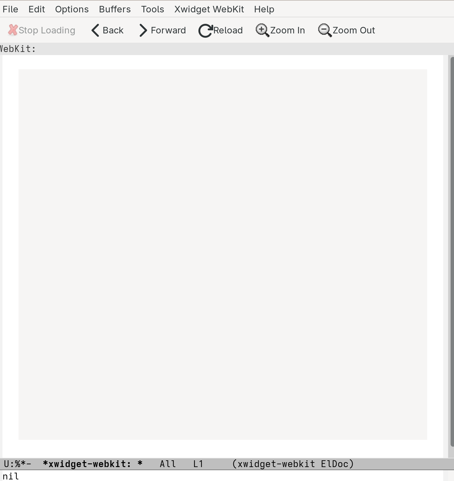

Hi, I am one of Nixpkgs Emacs maintainers and I am aware of that commit. Actually, it is me who tells you that commit in the matrix room.
I did plan to remove the xwidgets restriction from Nixpkgs. However, in my experiments, it did not seem to work: it just showed a blank screen after I evaluated (xwidget-webkit-browse-url "http://httpforever.com/"):
