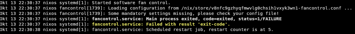

In the journalctl of fanconfig it states that the generated file is broken.
Any idea what the problem is here and how to fix this?
