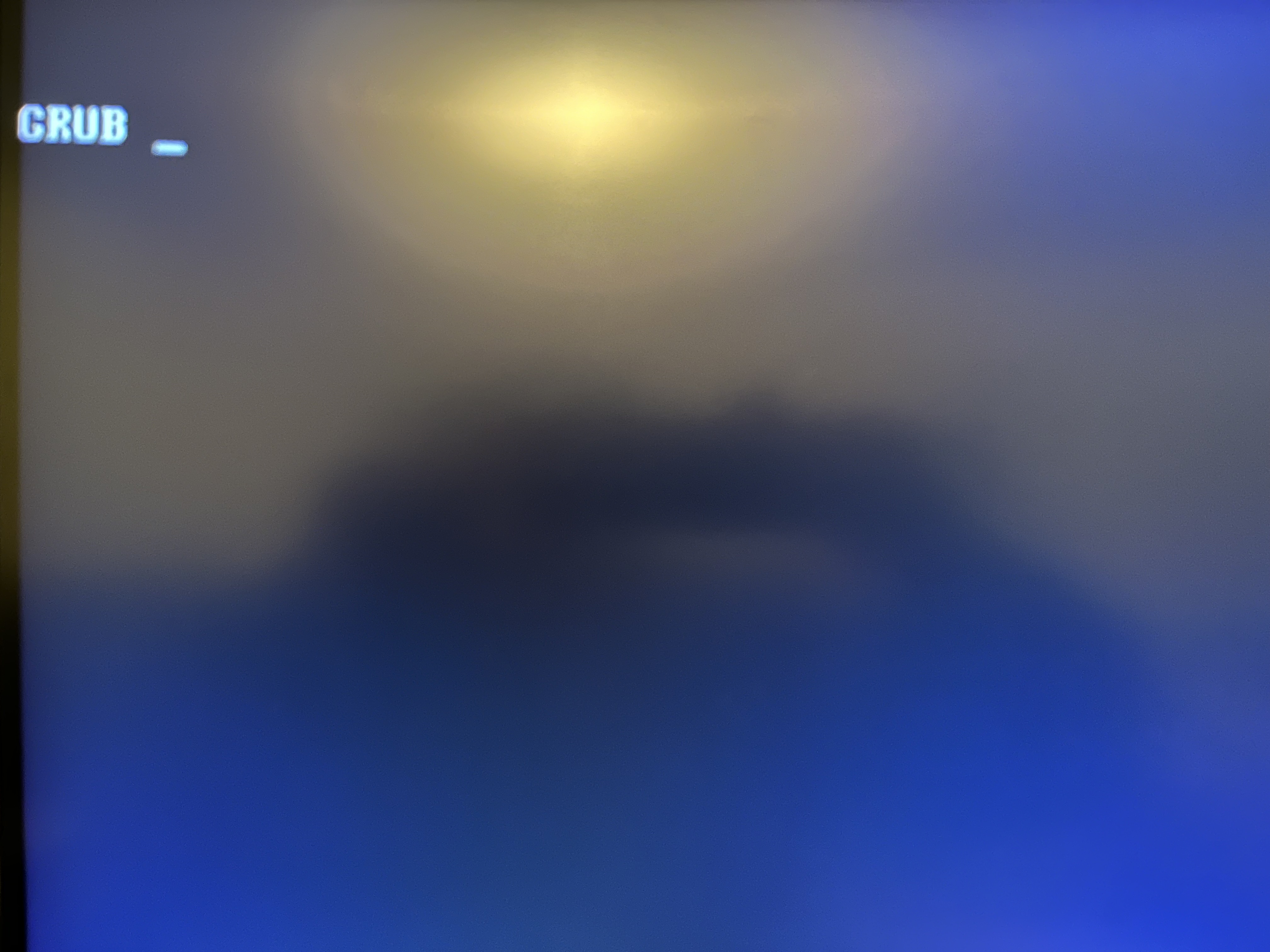

Fresh installation with systemd-boot and zfs, but boot fails at GRUB black screen
Hi all, I’ve previously only used NixOS with GRUB and zfs, and have that config dialed in reliably. But now I’m working on a fresh new configuration using a similar zfs config, but with systemd-boot instead.
Installation works without error, but it throws a warning about /boot being world accessible. And when I reboot into the system, booting hangs at a black “GRUB” screen with no options or interactivity. Screenshot from my phone:
I’ve tried many different iterations, but same problem every time.

Either that grub is being reinstalled from your config, which I didn’t spot a cause for in a brief read, or it’s not being wiped fully.
I suspect you may have it lurking in the boot sector, from a BIOS booting mode; it looks like your wipe is only clearing partitions. I’m not sure how much of the bootsector that sgdisk zaps, but it seems like it might be only the partition table? That would be consistent with it only printing the id and not loading the rest of grub. Try dd’ing some zeroes over the first MB or so of the disk.
Also, check your boot settings… you might actually be booting off a different device, and you probably want to be in EFI mode anyway.
Yea, to expand on this part a little bit, I would disable CSM if I were you to avoid the option of legacy BIOS booting altogether. And I would use efibootmgr to check for unexpected UEFI boot entries.
