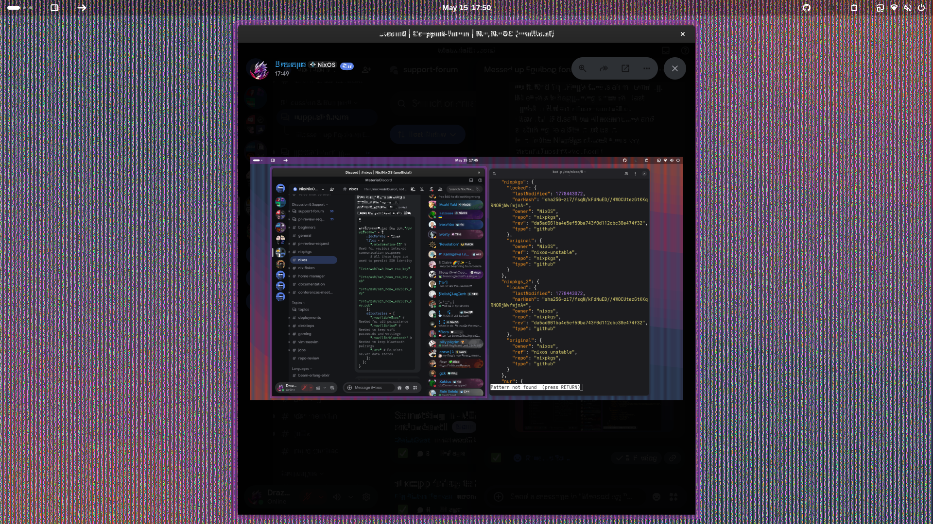

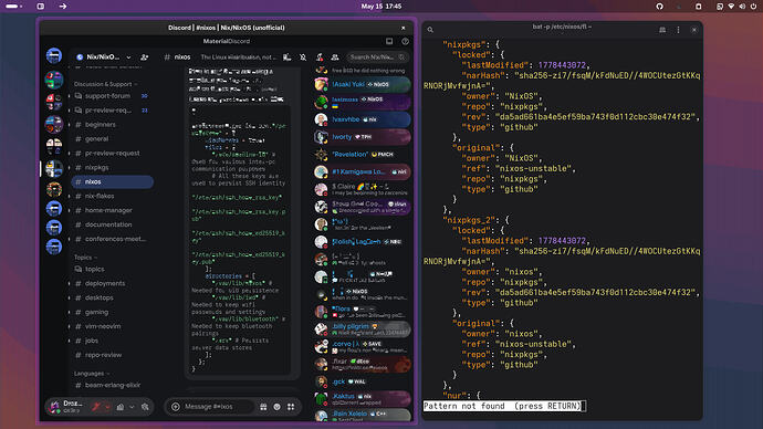

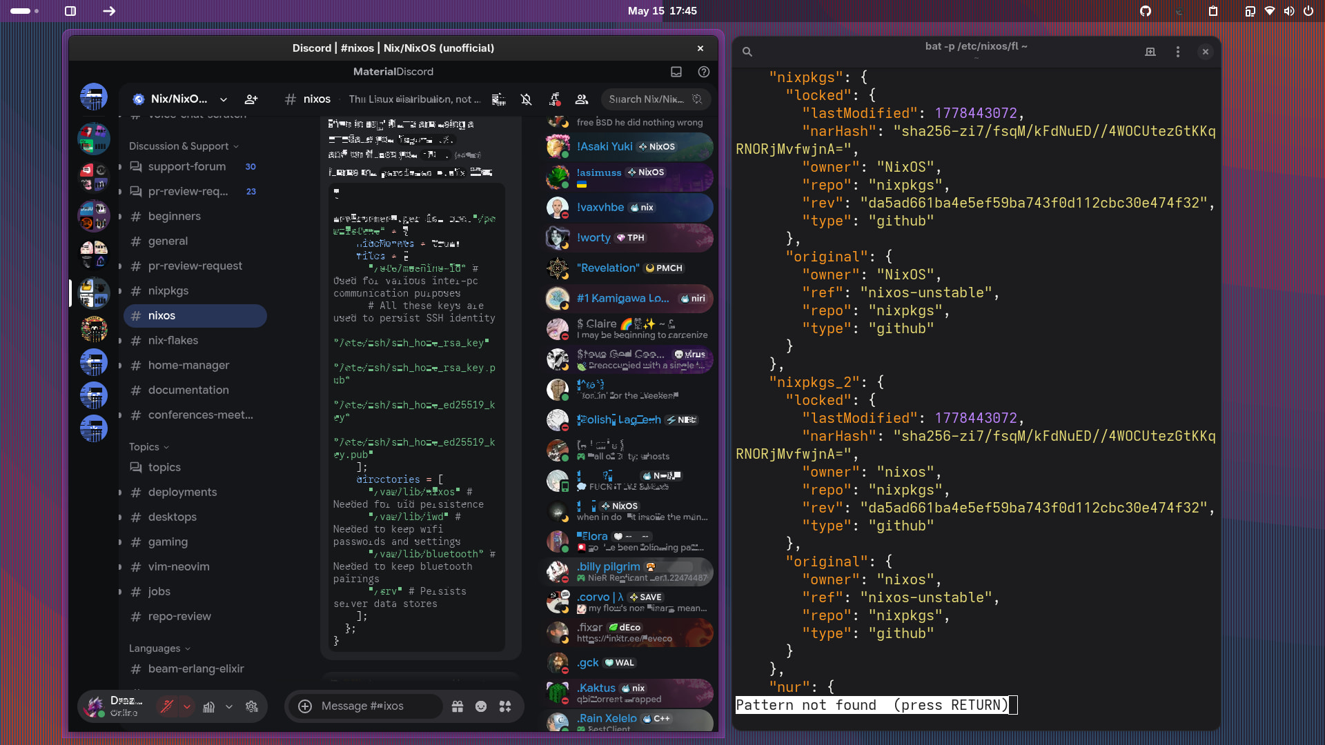

Each workspace has a different weird static on it. And Equibop’s font is all messed up. All of this is happening since the last update I did on nixos-unstable.
I have tried disabling all extensions and switching to a different user.
Here’s the Nixpkgs attrset from my /etc/nixos/flake.lock:

And if I switch to a different workspace and come back to the default one, the static gets worse:
I tried the same configuration and home directory (copied from the problematic host), and the issue does not persist
The issue was on all Electron apps. Some update today solved it.
