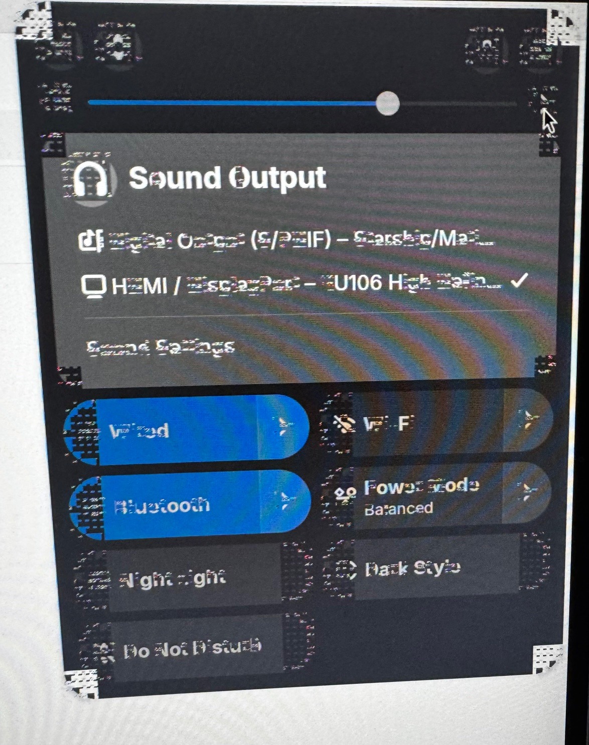

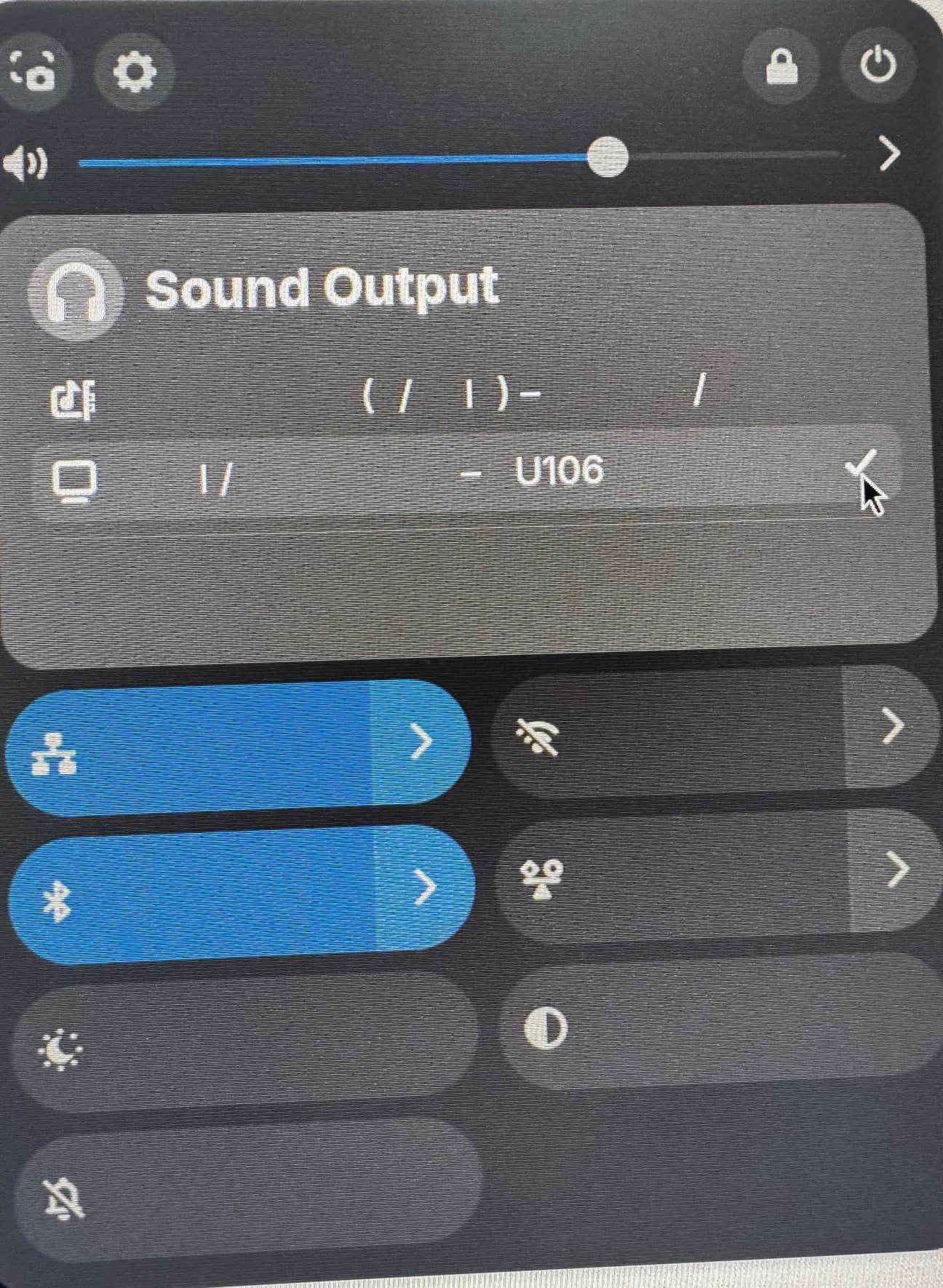

Gnome/GDM glitches after suspending/sleep
Sorry for the late reply. I have an RTX 4070ti.
I get the same issue with an RTX 3070.
Interesting. That means I’m on the Pascal architecture (before the open source driver era), while @llakala and @dingaling are on the Ampere and Lovelace architectures (supported by open source drivers). I’m surprised to see this problem across such a wide range of architectures.
