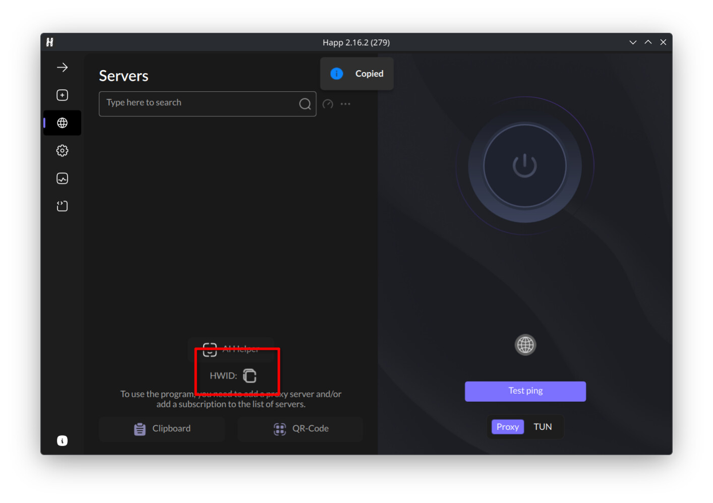

well, that is good! but HWID send doesn’t work, it seems like my HWID is empty
Given how picky the Nix Repo maintainers are, I don’t think it’s worth the effort. Thanks for feedback.
The HWID issue has been resolved in version, v0.2

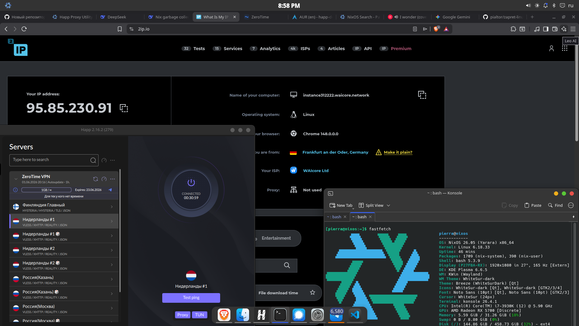

happ-nix - modern flake with program and nixosModule which also works on wayland
thanks MrShitFox for inspiring, i didn’t watch into problem with Hysteria, but vless and tun work so i am happy
