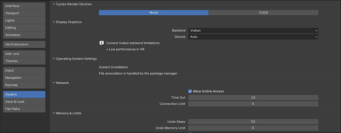

I’m on Nixos stable 25.11.
I have an RX 7800 XT.
Based on GPU Rendering - Blender 5.0 Manual Blender should have HIP support on this hardware.
Following AMD GPU - NixOS Wiki I’ve installed the blender-hip package (and blender of course), and I have this in my configuration:
  hardware.graphics = {
    enable32Bit = true;
  hardware.amdgpu.opencl.enable = true;
  systemd.tmpfiles.rules = [
    "L+    /opt/rocm/hip   -    -    -     -    ${pkgs.rocmPackages.clr}"
I wasn’t sure whether I needed the tmpfiles stuff but included it.
After all that, in Blender’s system preferences under cycles render devices I expect to see HIP as an option, but I don’t.
Any ideas?

Unfortunately no luck. I added all missing pieces of the above, built/switched, and restarted, but still no HIP option.
Just in case I’m being an idiot, I’m expecting a “HIP” option alongside “none” and “CUDA” here, right?
Oh! I read your message again, specifically “I have only installed the blender-hip package” and so I tried removing blender to just leave blender-hip, and now the option appears!
