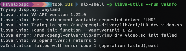

I am getting this output. is this working as expected?
or should I solved the failed something there?
Yep, that’s broken. I don’t actually own any intel hardware, so I can’t support any further as far as debugging the actual driver goes. Looks like the driver is properly installed and configured, but fails to function in practice.

i am still getting the same error even after started using nixpkgs unstable for my system :face_holding_back_tears:
looks like your CPU (i7-4500U) is not supported by intel-media-driver, but by the older libva-intel-driver. see: Hardware video acceleration - ArchWiki
ensure your hardware config looks like this:
  hardware.graphics = {
    extraPackages = with pkgs; [
      intel-vaapi-driver # For older processors. LIBVA_DRIVER_NAME=i965
  environment.sessionVariables = { LIBVA_DRIVER_NAME = "i965"; };
If you have both drivers already in the extraPackages list, you can test it out by running LIBVA_DRIVER_NAME=i965 vainfo
Gah, you’re right! I’m so sorry, I was convinced the i7-4500U was Broadwell. See the support table here: GitHub - intel/media-driver: Intel Graphics Media Driver to support hardware decode, encode and video processing.

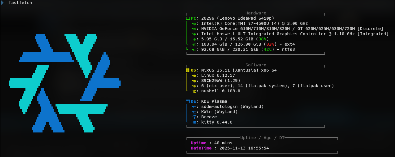

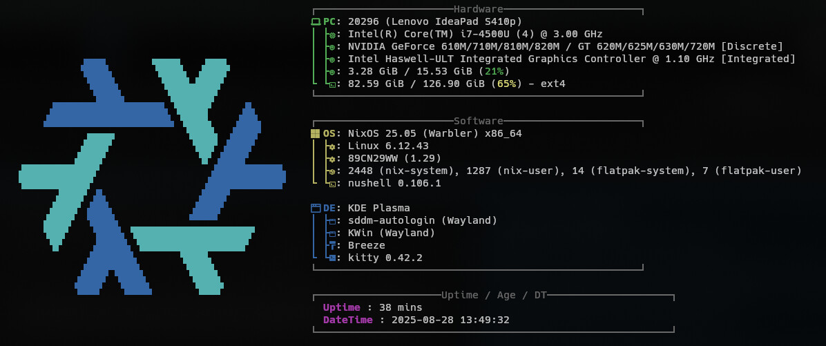

ok makes sense. Also Should I specifically mention my nvidia graphics too? Or it’s drivers are loaded automatically by the system?
my fastfetch output for reference:
This depends. By default I believe only your iGPU will be used. But maybe it isn’t and that’s why playback isn’t working?
