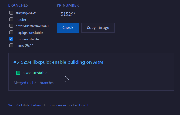

I appreciate all the replies.. I still am using it as I type this message but I will say there are some growing annoyances that I am still trying to work with and feel some frustration. I don’t like how long it’s taking them to fix the ‘libcpuid’ package on aarch64, I reported it days ago and it’s still a problem bringing my entire system to a halt for installing packages unless I echo something into my terminal every time.. Like honestly? Why? The package is already compiled and on my system, so why isn’t it intelligent enough to shut up about it?
And then of course the tor-browser being absent from the aarch64 repos is another brutal one, since NixOS is the only distro it appears I can’t run the software on simply because I’m held hostage by it not being maintained by Nix?
And also how slow they’ve moved on libcpuid I’m guessing it’s gonna be MONTHS before we see a tor-browser package
All in all, I have some definite frustrations but it’s not directed at anybody here of course and regardless of everything I do appreciate the help as always
Officially x86_64-linux gets the primary support.
But honestly it feels like ARM darwin gets better support than tier 2 based on number of users. That is to say, more help would be appreciated, since aarch64-linux doesn’t get enough love.
It’s fixed, hydra just needs to build everything that’s changed and run tests. In fact current nixos-unstable is fixed, you just need to update your channels.
