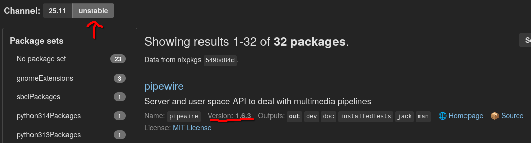

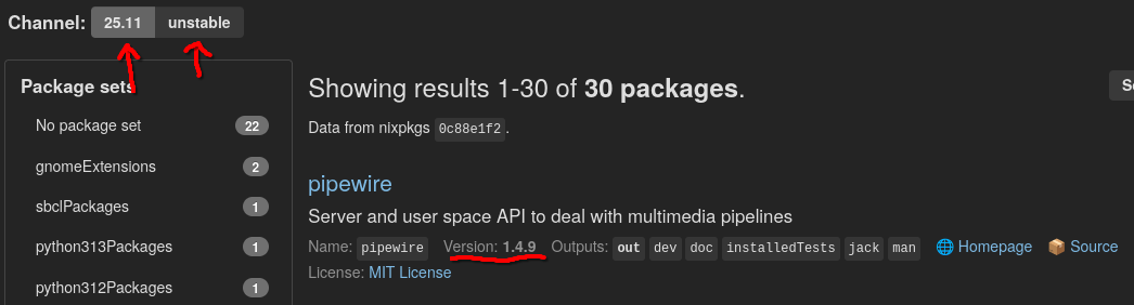

Pipewire should have the version 1.4.9.
If you search for pipewire on search.nixos.org
you can see the current version if you are on version 25.11
if you select unstable you can see that version 1.6.3 is already supported on the unstable branch.
