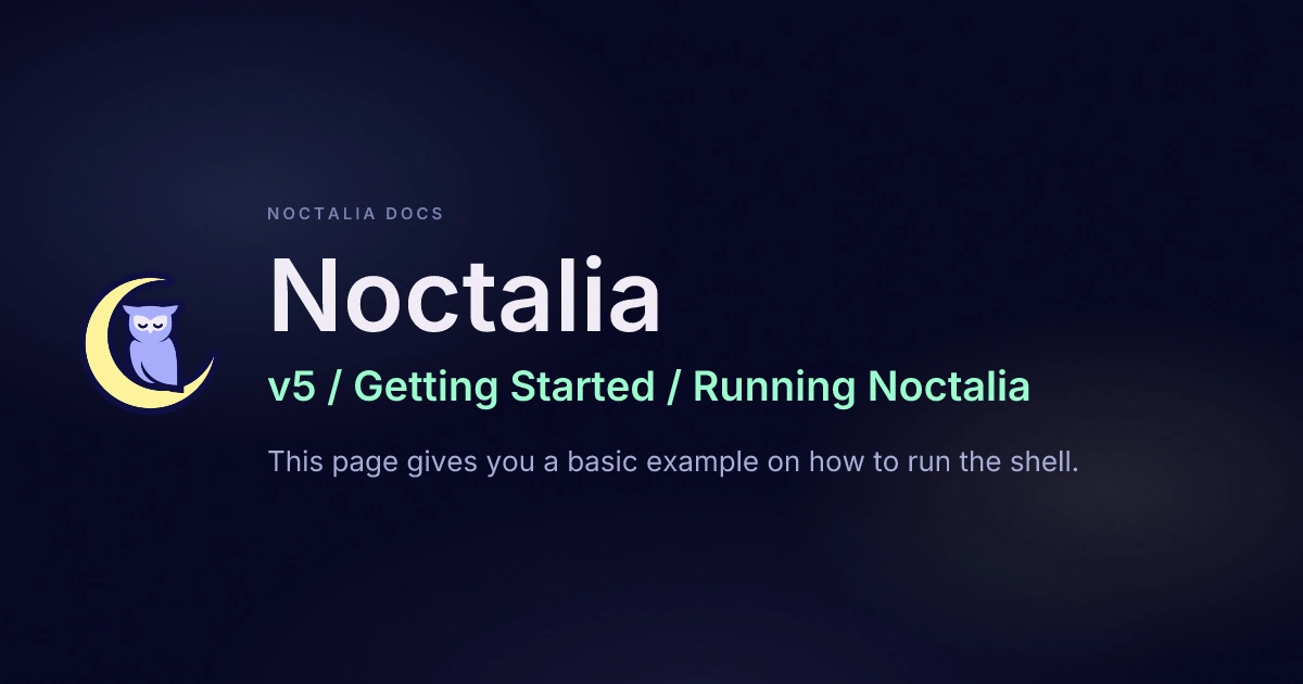

I’ve been unable to find any documented way to configure Hyprland, in the Nix config, to start Noctalia. Using the compositor to initialise Noctalia is the only recommended method as opposed to starting from systemd which is depreciated.
The Noctalia docs only lists the Lua config which does not yet exist. This is a pre-build step to boot straight from the Display Manager into a fully functioning base install of Hyprland-Noctalia.

I might be wrong, but I think using noctalia-shell is more correct than noctalia. (source)
The link above shows the settings for niri as an example, and looking at this, niri.settings.spawn-at-startup is equivalent to hyprland.settings.exec-once.
Also, while the second link uses qs -c, the first link shows that you can run it directly with noctalia-shell as well.
It’s actually working perfectly in my environment, too.
I don’t fully understand the difference between them myself, so I can’t give a detailed explanation. Sorry about that!
I apologize, I was referring to a different version.
