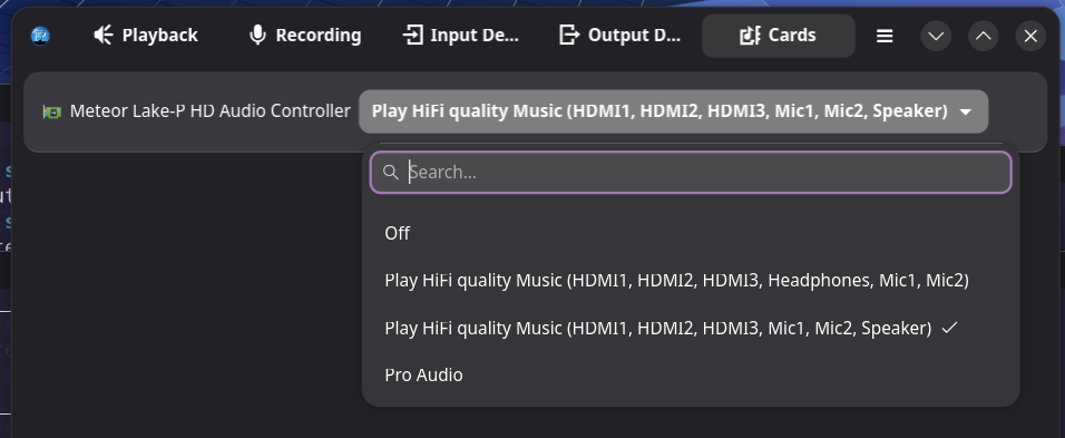

Hello! I recently installed NixOS for the first time on my laptop and I noticed that whenever I plug in my headphones into the headphone jack, there is no audio in both the speakers and through my headphones.
Upon installing pwvucontrol, I noticed it was because the audio controller wasn’t automatically switching profiles when I plug them in. Clicking on the profile with “Headphones” in the title caused audio to correctly play through my headphones, but I had to manually switch back to speakers when I was done with them.
This problem is apparent just for the headphone jack; Bluetooth, the built-in speakers, and even a wired connection through USB-C work and switch between each other perfectly fine.
How can I configure NixOS to automatically detect my wired headphones and change audio controller profiles when I plug my headphones into the headphone jack?
Below are the relevant lines in my Nix config as well as the output of wpctl status, both while I have my headphones plugged in but the “Speaker” profile still selected.

I had to add udev rule?
Hi, thx for the reply! Where exactly can I find information about adding a udev rule to get the desired behavior for my case? I have never had to mess with those before and I hadn’t even heard of udev rules until I looked it up after reading your post. Based on what I found, it seems to interact with the hardware at a really low level and I can’t figure out on my own how to use them to specifically configure wired headphone detection…

Hey, I appreciate the pointers for udev and I certainly learned something new today! However, I found something that makes me doubt that the existing udev rules are the problem…
Just for fun, I decided to disable pipewire and switch to pulseaudio in my config, like so:
	services.pulseaudio.enable = true;
	services.pipewire.enable = false;

And the behavior is completely different; the problem appears resolved as plugging in and removing my headphones does correctly toggle between the headphones and speakers, respectively. Given that pipewire is pretty much objectively better than pulseaudio, this is by no means a permanent solution. I do hope this steers us in the right direction for resolving the problem, though =)

Hi, I am not entirely sure how I did it, but I was able to get pipewire to behave with the audio jack, but might have something to do with me switching from KDE to Sway. I appreciate the help, and I will post on this thread again if anything changes.

I think it’s more that KDE runs a suite of services to monitor hardware hotplug, and switching audio outputs is one of the services it supplies (poorly, in this case).
