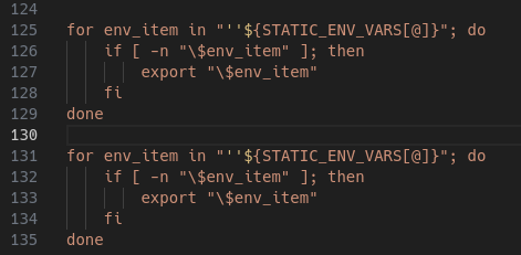

I don’t know what i do wrong…
In intended strings you escape the ${ by using ''${.
   installPhase = ''
 mapfile -t STATIC_ENV_VARS < <(${yq-go}/bin/yq '.env[] | select(test("^\\[macos\\]") == false) | sub("^\\[linux\\]\\s*", "")' "\$Static_LAUNCHER_YML" 2>/dev/null)
-for env_item in "${STATIC_ENV_VARS[@]}"; do
+for env_item in "''${STATIC_ENV_VARS[@]}"; do
     if [ -n "\$env_item" ]; then
         export "\$env_item"
     fi
 done

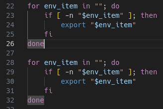

thanks for the fast reply.
It didn’t work for me:
        export "\$env_item"
    fi
done
"''${STATIC_ENV_VARS[@]}"""
What does this mean? Do you see "" in the rendered script? Or is the STATIC_ENV_VARS just empty?
As a matter of debugging, you might want to add a simple echo $STATIC_ENV_VARS between mapfile and the loop.
I see "" in the rendered script.

I have no clue what file you looked at in that video, though it might have been through additional stages. I just realized that you have a <<EOF…EOF slapped around the area.
So maybe you are missing some bash escaping on top, making it "\''${…}" should break that level.
That was it. Huge thanks <3
"\''${DYNAMIC_ENV_VARS[@]}""${STATIC_ENV_VARS[@]}"
