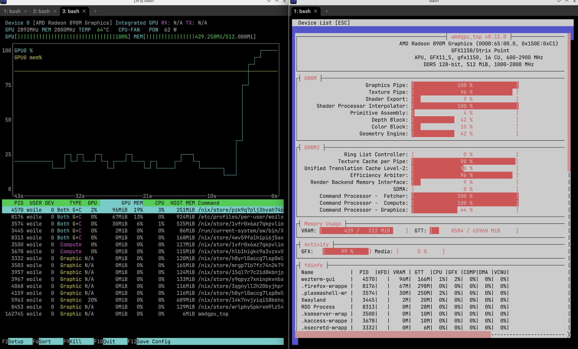

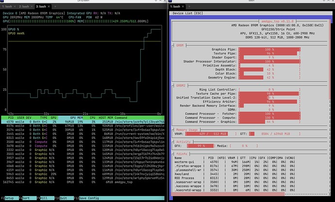

hmm, do you see the ram and usage spike in nvtop? It does work with AMD cards nix-shell -p nvtopPackages.amd they feel a little low for an 8b model.
Here’s nvtop on the left and amdgpu_topon the right.
For vulkan
For rocm

@knix I tried your config (which I think it’s duplicated in your example), and the result is the same, you might be getting a few more seconds because it’s a Max+ 395.
If you use vulkan do you also see a performance increase?
ollama 0.14.3 is out in unstable, I’m gonna try it. Update: no gains
I recently found out that llama.cpp has something called llama-server repo has anyone played with it? Could it work as a replacement to ollama?
I sometimes use llama-server. In itself, it is not for managing the downloaded models or whatever, it is pirmarily for configuring and launching a model from command line, then having an API to it, with a small Web UI. The UI is minimalistic but it works pretty fine (and it doesn’t need to do too much).
Possibly you could use it together with llama-swap to choose from a Web UI which model is currently loaded.
For managing the model downloads you need something else, I think.
I recently figured out that my system is utilizing the cpu only and in some configs when ollama sees the GPU (8060S) it crashes. That is the case for 25.11 and for unstable.
So these numbers were actually not representative …
I will post the result again when it runs correctly - this might take a while.
With llama-server, do you refer to systemd service that runs ollama?
That is what I actually use, with a lot of trying what works and what not, hence the comments ….
  services.ollama = {
    #package = pkgs.ollama;
    #package = pkgs.ollama-rocm;
    #package = pkgs.ollama-vulkan;
    #package = pkgs.llama-cpp-rocm;
    #acceleration = "rocm";
    #acceleration = "vulkan";
    #loadModels = [
      #"llama2"
      #"llama3.1:8b"
      #"mistral:7b"
      #"mistral-small3.2:24b"
      #"ministral-3:14b" # Version > 14.0 needed!
    #environmentVariables = {
    #  OLLAMA_HOST="0.0.0.0:11434";
    #  #HSA_OVERRIDE_GFX_VERSION = "11.5.1";
    #  #HIP_VISIBLE_DEVICES = "1";
    #  #ROCR_VISIBLE_DEVICES = "1";
    #  #OLLAMA_LLM_LIBRARY = "rocm";
    #  #HCC_AMDGPU_TARGET = "gfx1151";
    #  #HSA_ENABLE_SDMA = "0";
    #  OLLAMA_DEBUG = "1";
    #  OLLAMA_CONTEXT_LENGTH = "131072";
    #  OLLAMA_KV_CACHE_TYPE = "q8_0";
    #rocmOverrideGfx = "11.5.1";
  users.groups.render.members = [ "knix" ];
No, it’s a tool in llama-cpp package.
Do you know if it’s available in nix? I couldn’t find it.
I use ollama as an API mainly, to integrate with my code editor. It would be nice if we have more alternatives in nix
llama-cpp is in Nixpkgs under this exact name. It has llama-server executable. Upstream name is llama.cpp for the package.
I’ve tried llama-server with both llama-cpp-rocm and llama-cpp-vulkan.
The results are the same as reported in the first post.
llama-server --host 0.0.0.0 --port 2000 --no-warmup \
  -hf mistralai/Ministral-3-8B-Reasoning-2512-GGUF:Q4_K_M \
  --jinja
I take this as a signal, that it’s not the tool per se, but proper support for rocm is not yet there.
By the way, I’ve tried the new Qwen3-Coder-Next-GGUF and it produces token at the same rate as ministral-3-8b, around 14 token/second. Seems like a good option for now.
nix-shell -p llama-cpp-vulkan
llama-cli \
    -hf unsloth/Qwen3-Coder-Next-GGUF:UD-Q4_K_XL \
    --fit on --seed 3407 --temp 1.0 --top-p 0.95 --min-p 0.01 --top-k 40 \
    --jinja
[ Prompt: 42,7 t/s | Generation: 14,0 t/s ]
