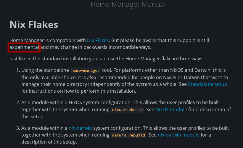

I then realized that home-manager via flake is experimental.
Home Manager is compatible with Nix Flakes. But please be aware that this support is still experimental and may change in backwards incompatible ways.

this is from the manual. what does the “experimental” mean here? is it nixos flakes or installing home-manager via flakes?
“Experimental” in most NixOS cases means it’s “stable” but there hasn’t been an effort to like finalize the 1% left.
As flakes are experimental, something based on it has to be experimental as well.
And IMHO that is here exactly the point for home-manager.
It’s just saying that it might change in a breaking way in the future and that is then because of changes for flakes, if they occur at some point in the time (or never)
