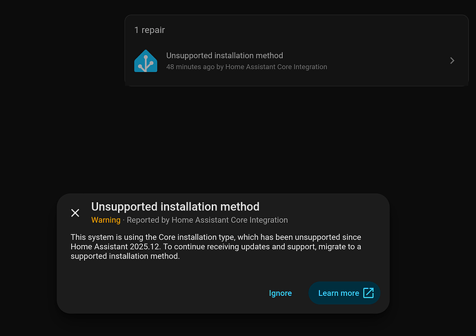

I installed Home Assistant with the nix module. Is this fine?
I’m on Nixpkgs unstable and I copied the config from the nixos wiki: https://wiki.nixos.org/wiki/Home_Assistant. I just started trying home assistant.

Core just means “installing directly into a python environment”, which is the way you kind of need to do it for proper Nix packaging. The only 2 supported methods now are HA OS and the container. It should be fine. Also one of the core HA developers is very hostile to Nix and has no clue how FOSS or Nix work:
Also, the decision to stop supporting Core was based on opt-in analytics, which is a horrible way of telling who is using advanced features (as most people using advanced features will not enable analytics, and will opt out if it is enabled by default): Deprecating Core and Supervised installation methods, and 32-bit systems - Home Assistant
If you really want you can run it in a container as a Quadlet with GitHub - mirkolenz/quadlet-nix: NixOS module for Quadlet / podman-systemd · GitHub, which is closer to the upstream path.
We, the nixpkgs home-assistant maintainers, think it’s going to work out. The support situation isn’t changing, they don’t want our issues, unless they are reproducible on officially supported setups.
Your first point of contact is #homeautomation:nixos.org or the nixpkgs issue tracker. We’ll keep supporting home-assistant on nixpkgs as long as we can, and we’ll likely patch this warning out.
