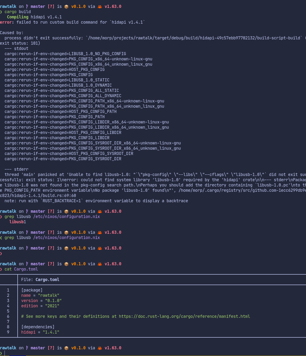

I installed libusb on nixos which is dependent on the hidapi library. I installed the library by adding the following to my /etc/nixos/configuration.nix file and running sudo nixos-rebuild switch .
    pkgs.libusb1
However I have tried all the languages that implement the libusb api including C, lua, python and now rust but I cannot seem to get the libusb libary installed and have the .so exposed globalling for these langauges to pickup to experiment. What is the best practice here? Create a default.nix? and include the required packages and launch a nix shell with nix develop ? If so is there a template or an automated manner of doing such a thing. Thank you. Any help would be greatly appreciated. See Screenshot below.
