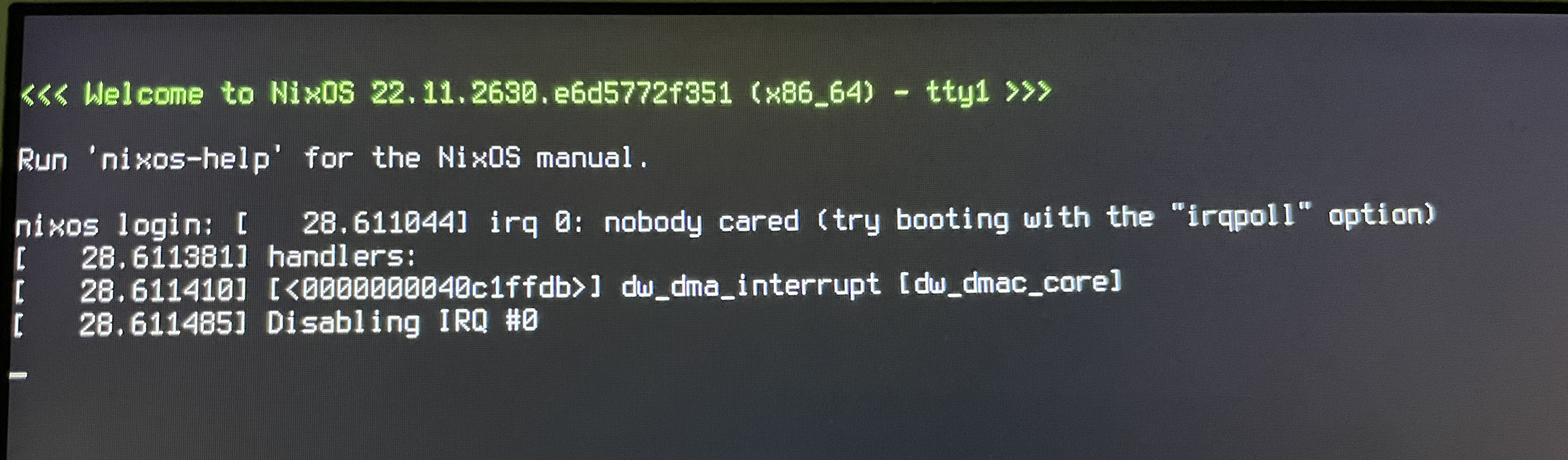

Irq 0: nobody cared (try booting with the "irgpoll" option) error on a new Nixos Install on a Macbook Air
Just installed Nixos 22.11 on an old Intell Macbook Air (I think mid-2012) I had, and I have no clue why this is happening. It appears after (~30secs) or so when I boot up the machine.

It “seems” like everything is working fine though.
Have you tried setting the irqpoll kernel argument?

I tried it (without the typo) but the error is still happening, this is what I can see from journallctl
Feb 19 19:14:54 nixos kernel: irq 0: nobody cared (try booting with the "irqpoll" option)
Feb 19 19:14:54 nixos kernel: CPU: 2 PID: 0 Comm: swapper/2 Tainted: P           O      5.15.94 #1-NixOS
Feb 19 19:14:54 nixos kernel: Hardware name: Apple Inc. MacBookAir6,2/Mac-7DF21CB3ED6977E5, BIOS 118.0.0.0.0 08/06/2019
Feb 19 19:14:54 nixos kernel: Call Trace:
Feb 19 19:14:54 nixos kernel:  <IRQ>
Feb 19 19:14:54 nixos kernel:  dump_stack_lvl+0x46/0x5e
Feb 19 19:14:54 nixos kernel:  __report_bad_irq+0x35/0xaa
Feb 19 19:14:54 nixos kernel:  note_interrupt.cold+0xb/0x64
Feb 19 19:14:54 nixos kernel:  handle_irq_event+0xb1/0xc0
Feb 19 19:14:54 nixos kernel:  handle_edge_irq+0x99/0x280
Feb 19 19:14:54 nixos kernel:  __common_interrupt+0x41/0xa0
Feb 19 19:14:54 nixos kernel:  common_interrupt+0x7b/0xa0
Feb 19 19:14:54 nixos kernel:  </IRQ>
Feb 19 19:14:54 nixos kernel:  <TASK>
Feb 19 19:14:54 nixos kernel:  asm_common_interrupt+0x22/0x40
Feb 19 19:14:54 nixos kernel: RIP: 0010:cpuidle_enter_state+0xc7/0x350
Feb 19 19:14:54 nixos kernel: Code: 8b 3d 95 5d 1b 42 e8 78 4c a6 ff 49 89 c5 0f 1f 44 00 00 31 ff e8 99 63 a6 ff 45 84 ff 0f 85 >
Feb 19 19:14:54 nixos kernel: RSP: 0018:ffff9581400c3ea8 EFLAGS: 00000246
Feb 19 19:14:54 nixos kernel: RAX: ffff895cab32c5c0 RBX: 0000000000000008 RCX: 000000000000001f
Feb 19 19:14:54 nixos kernel: RDX: 0000000000000000 RSI: 00000000435e532a RDI: 0000000000000000
Feb 19 19:14:54 nixos kernel: RBP: ffff895cab335a00 R08: 0000001269da487d R09: 0000000000000008
Feb 19 19:14:54 nixos kernel: R10: 000000000000002b R11: 0000000000000028 R12: ffffffffbefb4340
Feb 19 19:14:54 nixos kernel: R13: 0000001269da487d R14: 0000000000000008 R15: 0000000000000000
Feb 19 19:14:54 nixos kernel:  ? cpuidle_enter_state+0xb7/0x350
Feb 19 19:14:54 nixos kernel:  cpuidle_enter+0x29/0x40
Feb 19 19:14:54 nixos kernel:  do_idle+0x1e5/0x280
Feb 19 19:14:54 nixos kernel:  cpu_startup_entry+0x19/0x20
Feb 19 19:14:54 nixos kernel:  secondary_startup_64_no_verify+0xc2/0xcb
Feb 19 19:14:54 nixos kernel:  </TASK>
Feb 19 19:14:54 nixos kernel: handlers:
Feb 19 19:14:54 nixos kernel: [<000000001dfd1745>] dw_dma_interrupt [dw_dmac_core]
Feb 19 19:14:54 nixos kernel: Disabling IRQ #0
