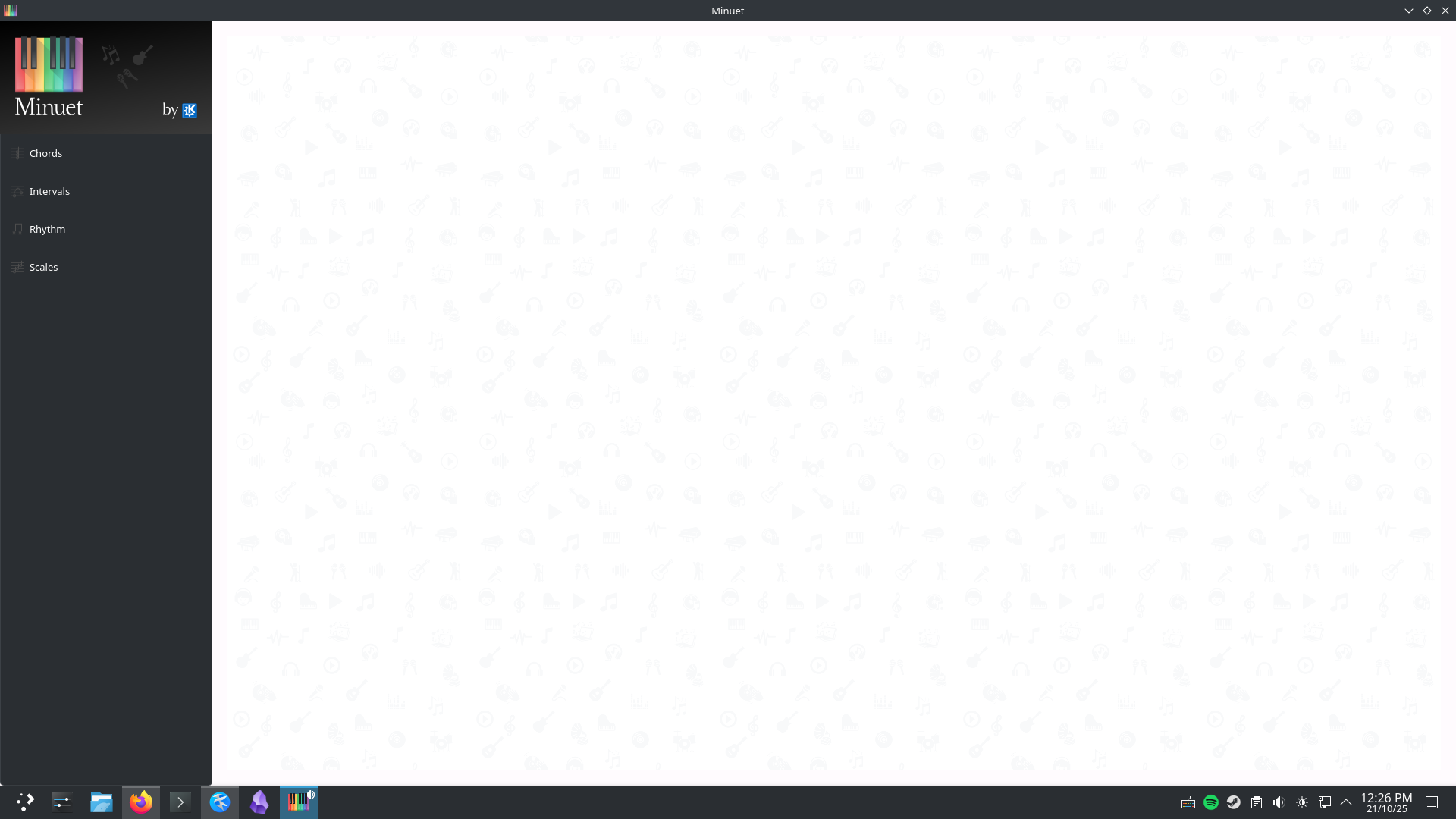

After adding kdePackages.minuet and opening the application I am greeted with the following:
I was expecting a “First-run configuration wizard” which did not happen.
Clicking on any of the topics open the related sub topic however bottom level categories do not contain any lesson links and the main panel remains blank.

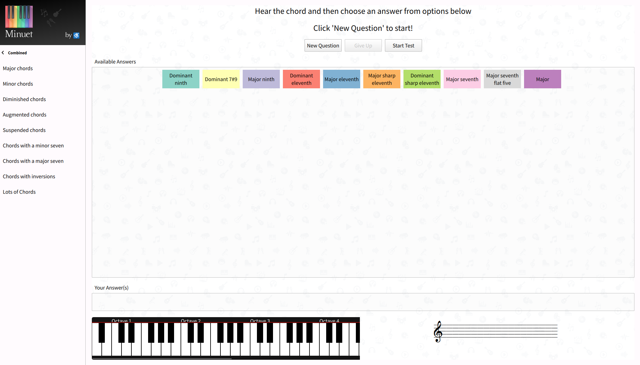

I can click into Chords > Combined > Major Chords and I do get an actual quiz:
All other quizzes I spot-checked loaded correctly.

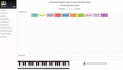

Thanks for replying. I’m on stable branch. I did check Chords > Combined > Major Chords just in case however it’s still blank for me. The ‘first run config’ is a bullet point from the KDE Minuet web page so it may not be important.
