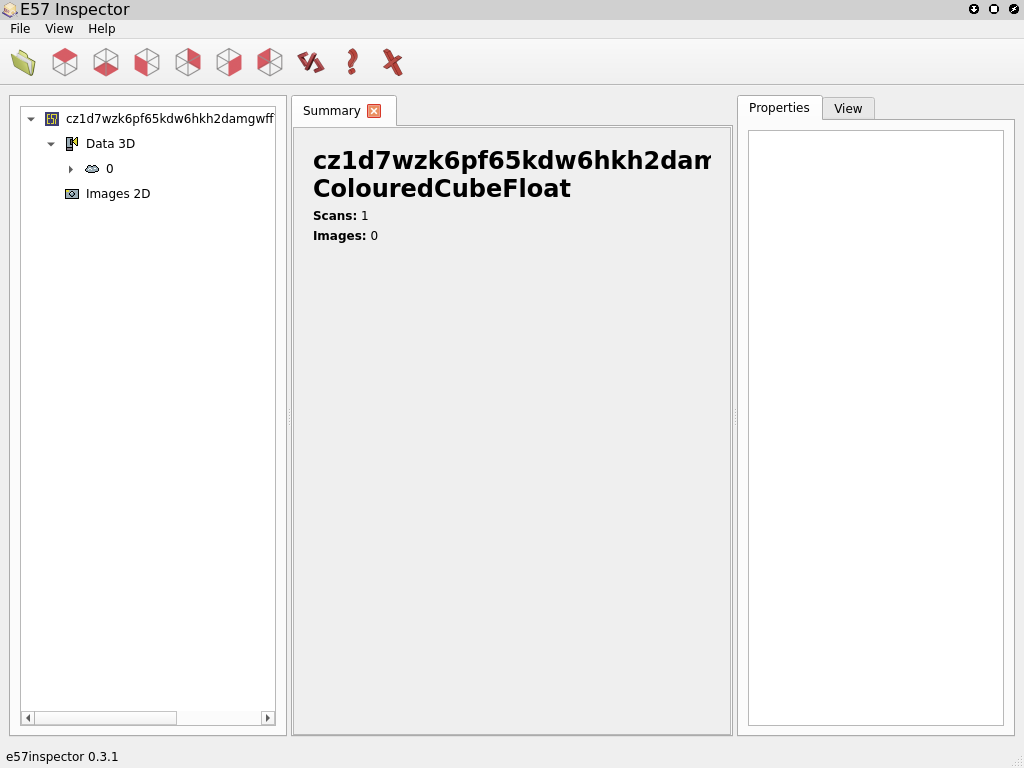

Example
Prompt:
Describe the given screenshot.
Next, answer this question and explain your answer:
Does the screenshot show a software application that has successfully loaded a thing called ColouredCubeFloat with some 3D scans in it?
Subsequently, output additionally exactly YES or NO for that question.
Screenshot:
Output:
The screenshot displays the interface of a software application, likely related to 3D scanning or visualization, named “e5Inspector”. The interface shows a file browser/viewer on the left and a main content area on the right.
On the left panel, there is a file structure showing a folder named “Data 3D” containing a file named “c1d7wzk6pf65kdw6hkkh2damgwff” and an “Images 2D” section.
The main content area shows a summary or details for a specific item. The title displayed is “c1d7wzk6pf65kdw6hkkh2danmwwff”, and below it, it states “ColouredCubeFloat”. Below this, it indicates “Scans: 1” and “Images: 0”.
The question asks whether the screenshot shows a software application that has successfully loaded a thing called ColouredCubeFloat with some 3D scans in it. Based on the text “Scans: 1” and the title “ColouredCubeFloat”, it suggests that the object or data named “ColouredCubeFloat” has been loaded, and it has 1 scan associated with it.
YES
Despite the model being quite small AND quantized from 16 to 4 bits, it’s already quite good at describing UIs.
