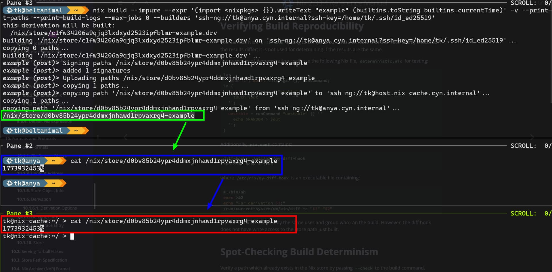

I’ve had some challenges setting this up, but I did get something somewhat functional:
  • building on host beltanimal sends build job to remote builder anya
  • anya builds the package & post-build-hook uploads to nix-cache, the nix-cache server
Manual nix builds work, but when other hosts try to use the remote builder during a nixos-rebuild it generally causes the nixos-rebuild to fail - probably because of the large number of paths being copied to the remote store.
This is the post-build-hook I’ve been using:

Never mind… I’ve solved the problem mentioned in my post above, and have arrived to a solution that I like, though it was not what I had originally wanted.
The solution is to use task spooler within the post-build-hook script, which prevents the nix copy commands from blocking a nixos-rebuild:
#!/bin/sh
set -eu
set -f
export IFS=' '
CACHE_HOST="host.nix-cache.cyn.internal"
if [[ -n "''${OUT_PATHS:-}" ]]; then
   export TS_MAXFINISHED=1000
   export TS_SLOTS=10
   echo "Uploading $OUT_PATHS"
   printf "%s" "$OUT_PATHS" \
   | xargs ts nix copy --to "ssh://tk@$CACHE_HOST"
fi
I found the solution in this thread.
