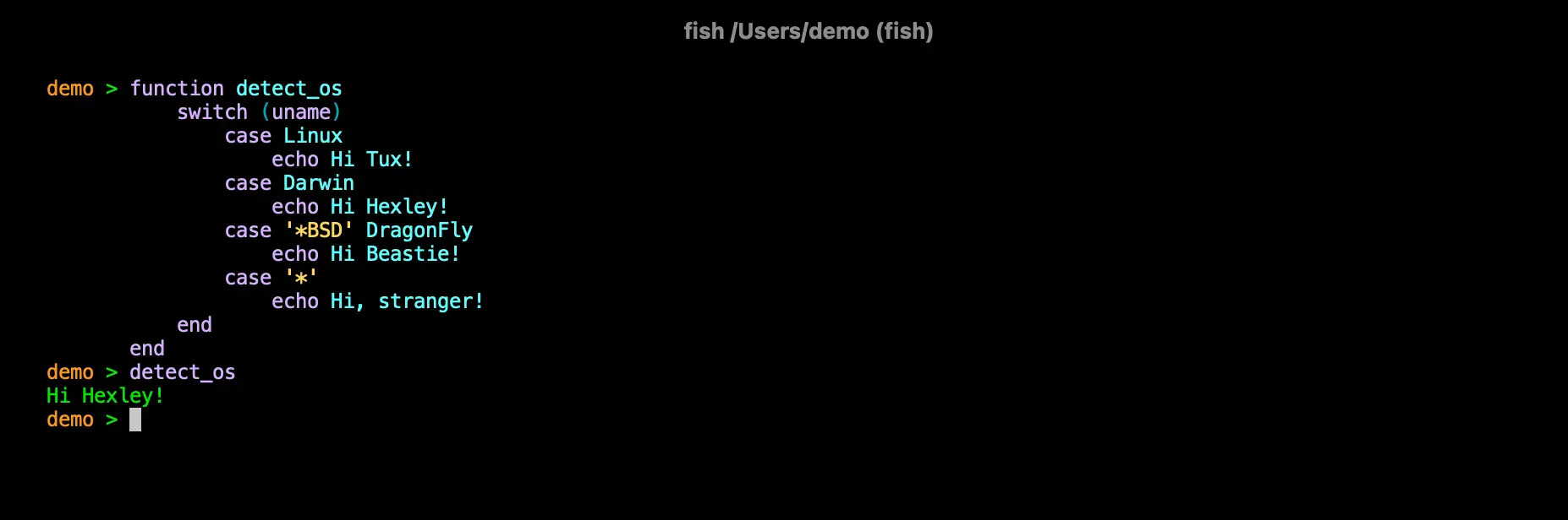

  • I’m personally a big fan of fish, which has some really nice scripting ergonomics, but is mostly posix-compatible enough that converting over derivations should not require many changes.
