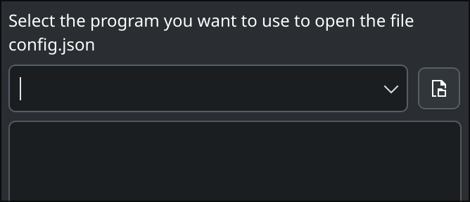

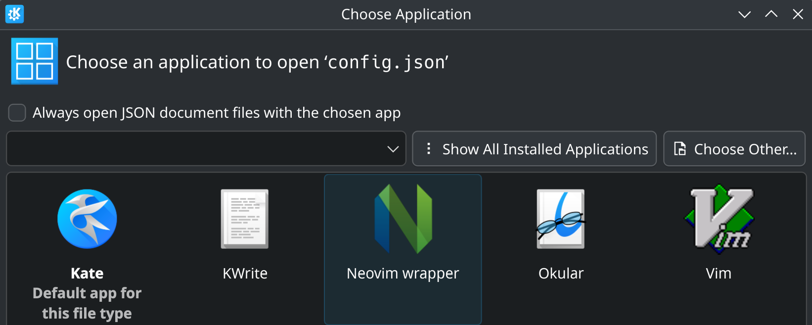

I have two WMs installed at the moment - Plasma 6 and Hyprland. In Plasma 6 on Dolphin, my file associations work fine, but on Hyprland they are totally gone:
My question is based on a fix here on KDE Discuss that seems to fix the problem - to create an alternate link to .../applications.menu.
Just tried it on a few other compositors (Wayfire, Niri). Seems like Dolphin’s file associations don’t work outside of Plasma in general at the moment. No issues with opening apps from other launchers, either.
As for KService, installing it declaratively had no effect, nor did the following command:
> kbuildsycoca6
kbuildsycoca6 running...
"applications.menu"  not found in  QList("/run/current-system/sw/etc/xdg/menus")

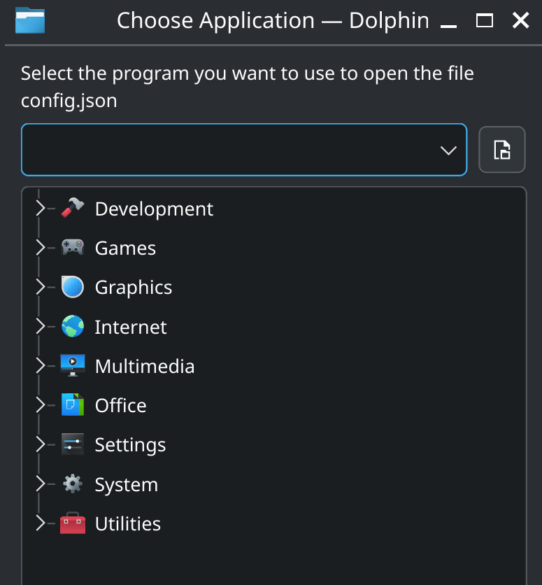

Indeed, your fix worked just fine (thank you!); however, the menu doesn’t look exactly the same as it does on Plasma 6.
(Top: Niri, Bottom: Plasma 6)
I suspect that Plasma 6’s Dolphin notices the category of file, and renders bigger icons accordingly based on items in the category.
However, now default apps open proper on Niri, and it seems to work fine.
