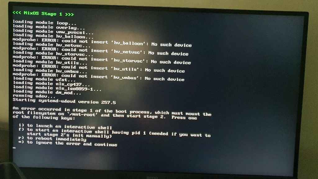

I am new to NixOS. I downloaded NixOS 25.05 iso file. The checksum are matching. I flash my USB drive. I booted NixOS and got this error:
An error occurred in stage 1 of the boot process, which must mount the root filesystem on /mnt-root and then start stage 2.

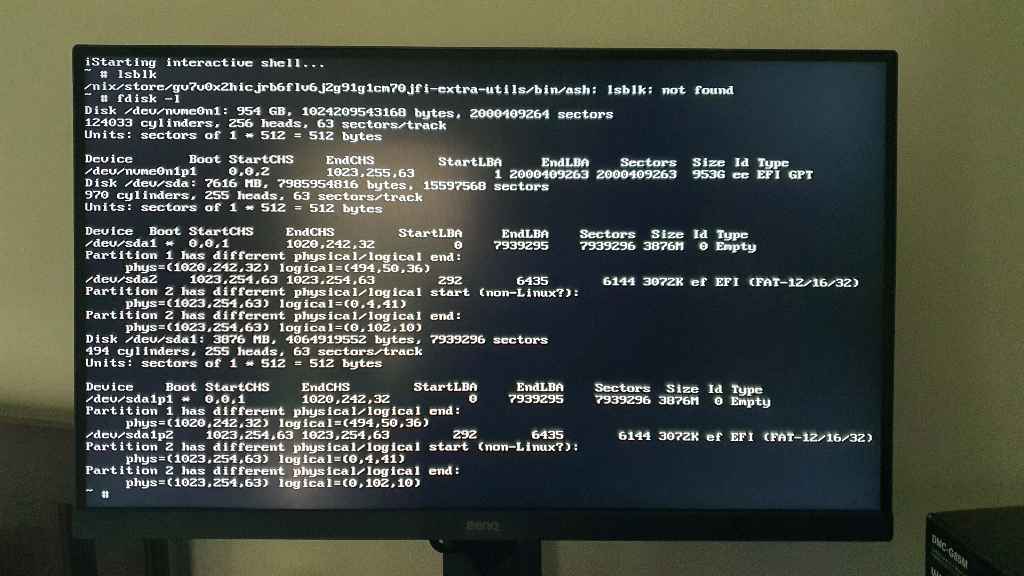

I pressed i and run:
I flashed NixOS twice but error persist. What can I do?
What did you use to flash it?
I used Chromebook Recovery Utility which worked for debian and endeavouros. Should I used anything different?
I’ve never heard of that tool before so I can’t say for sure if it does what nixos needs it to do. For GUIs I always recommend either Balena Etcher or Rufus
Thank you it fix the issue.
