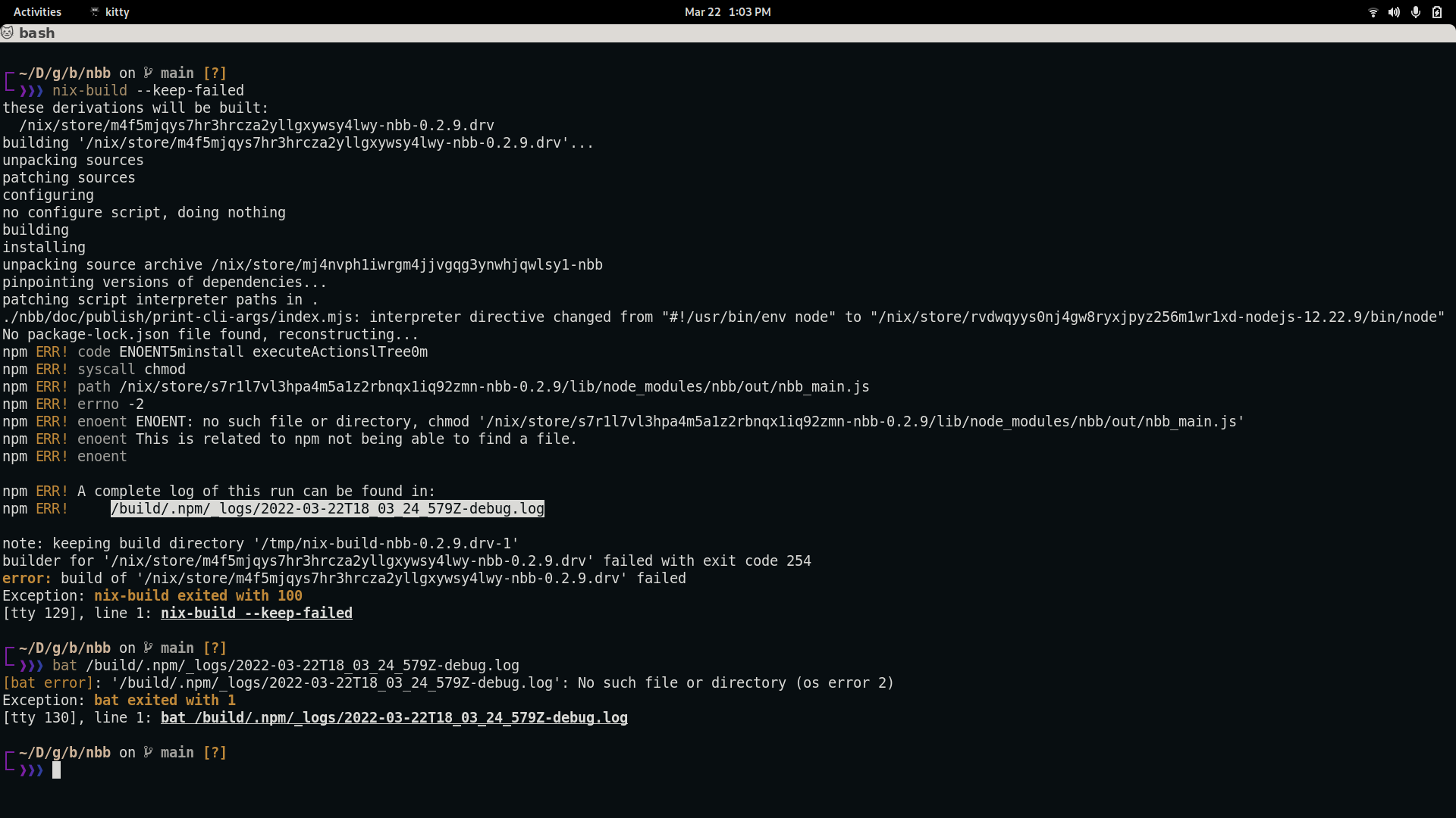

I think you can use the --keep-failed flag to preserve those logs.
doesn’t seem to work :confused:
It’s a bit confusing since there are a few layers here, the path with /build is spit out by NPM, but you also need the path from nix, see the note: keeping build directory line.
So looks like the log should be in /tmp/nix-build-nbb-0.2.9.drv-1/.npm/_logs.
Oh wow. I would have never figured that out.
