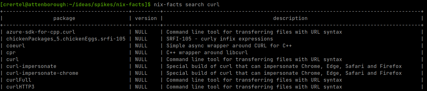

nix-facts search will search out a package

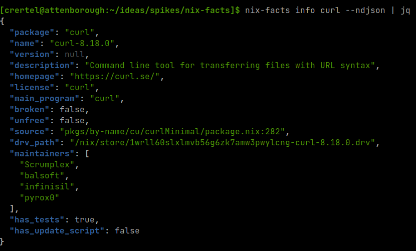

nix-facts info will let you see various facts about a particular package. It (like all the other commnads) can output newline-delimited JSON for scripting:

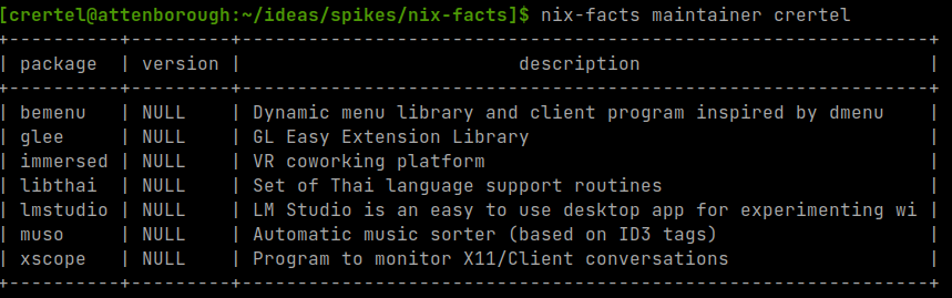

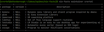

nix-facts maintainer will let you see information about a particular maintainer:

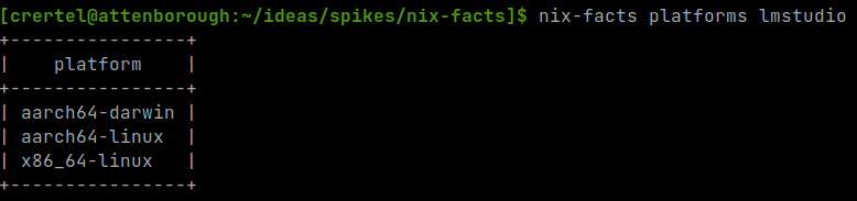

nix-facts platform will let you see what architectures are supported for a particular package:

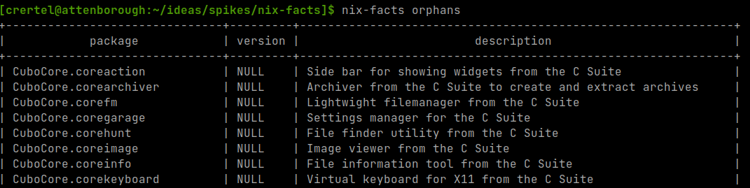

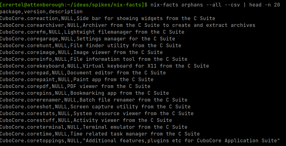

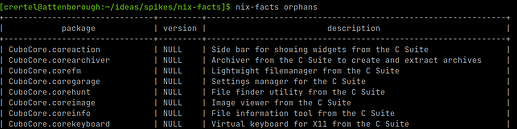

nix-facts orphans will show all orphaned packages in nixpkgs.

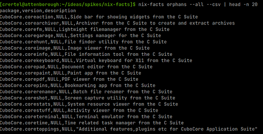

Note that you can also get this as a full list and CSV:

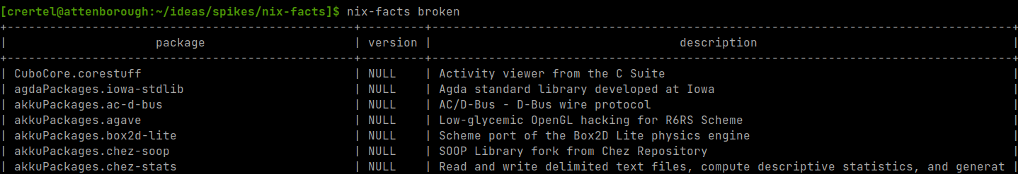

nix-facts broken lets us see all the broken packages:

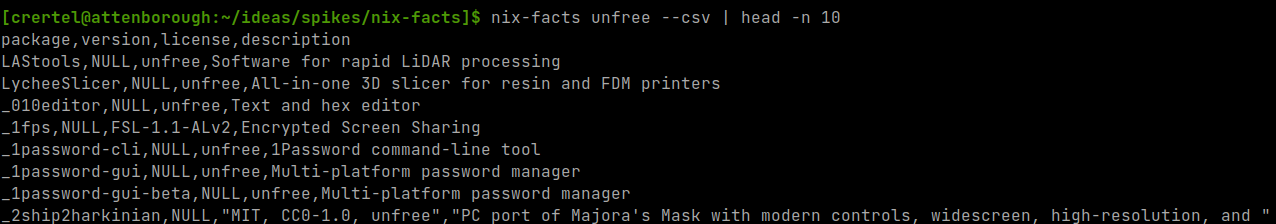

nix-facts unfree lets us similarly observe what packages are unfree:

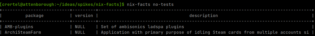

nix-facts no-tests helps find packages that don’t have tests (missing passthru.tests attribute):

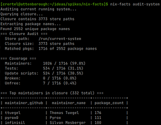

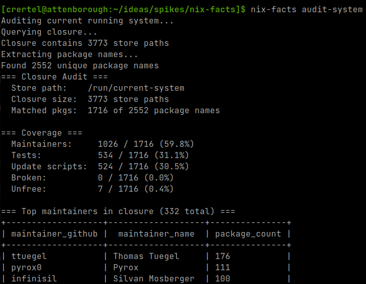

nix-fact audit-system will look at your running system and give you information about what’s on it:
It also provides several other tables that help you see which packages you’re running that are nonfree, broken, unmaintained, missing tests or updates, and so forth.

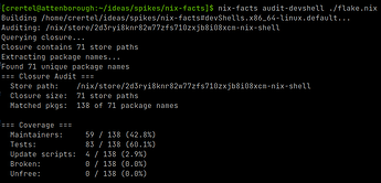

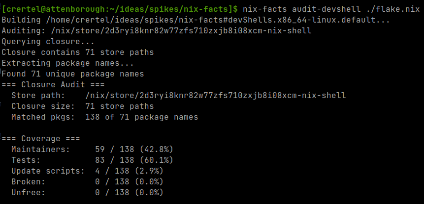

With nix-facts audit-devshell you can also audit the devshell for any flake:

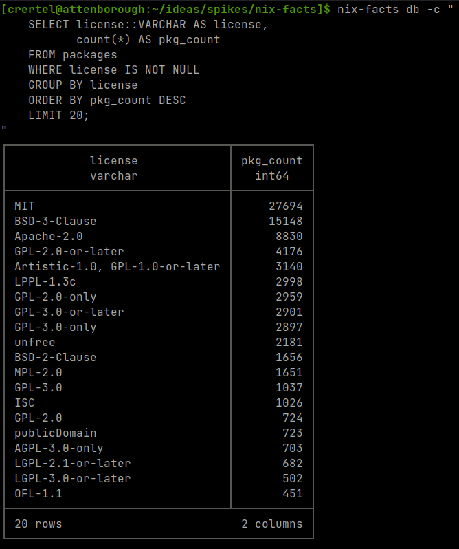

All of this is powered by DuckDB, and nix-facts db lets you run queries against the parsed data directly:
