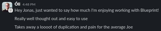

I think I accidentally stubled onto some nice design, because I keep getting feedbacks like this (I asked Oli if I could share):
