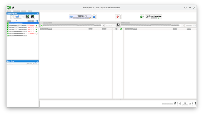

I’ve successfully upgraded to 26.05, however I ran into an issue for one flathub package I use: freefilesync
When I run the flatpak, I’m met with the following issue with the font characters:
I believe noto sans is missing:
flatpak run org.freefilesync.FreeFileSync
(FreeFileSync:2): Pango-WARNING **: 12:16:50.203: failed to create cairo scaled font, expect ugly output. the offending font is 'Noto Sans 9.999'
(FreeFileSync:2): Pango-WARNING **: 12:16:50.203: font_face status is: file not found
(FreeFileSync:2): Pango-WARNING **: 12:16:50.203: scaled_font status is: file not found
(FreeFileSync:2): Pango-WARNING **: 12:16:50.214: failed to create cairo scaled font, expect ugly output. the offending font is 'Noto Sans Bold 9.999'
(FreeFileSync:2): Pango-WARNING **: 12:16:50.214: font_face status is: file not found
(FreeFileSync:2): Pango-WARNING **: 12:16:50.214: scaled_font status is: file not found
(FreeFileSync:2): Pango-WARNING **: 12:16:50.215: failed to create cairo scaled font, expect ugly output. the offending font is 'Noto Sans Bold 9.999'
(FreeFileSync:2): Pango-WARNING **: 12:16:50.215: font_face status is: file not found
(FreeFileSync:2): Pango-WARNING **: 12:16:50.215: scaled_font status is: file not found
(FreeFileSync:2): Pango-WARNING **: 12:16:50.647: failed to create cairo scaled font, expect ugly output. the offending font is 'Noto Sans 9.999'
(FreeFileSync:2): Pango-WARNING **: 12:16:50.647: font_face status is: file not found
(FreeFileSync:2): Pango-WARNING **: 12:16:50.647: scaled_font status is: file not found
(FreeFileSync:2): Pango-WARNING **: 12:16:50.668: failed to create cairo scaled font, expect ugly output. the offending font is 'Noto Sans Bold 9.999'
(FreeFileSync:2): Pango-WARNING **: 12:16:50.668: font_face status is: file not found
(FreeFileSync:2): Pango-WARNING **: 12:16:50.668: scaled_font status is: file not found
I have the following in my nix config file:
#Install fonts
fonts.packages = with pkgs; [
	noto-fonts
	noto-fonts-cjk-sans
	noto-fonts-color-emoji
	liberation_ttf
	fira-code
	fira-code-symbols
	mplus-outline-fonts.githubRelease
	dina-font
	proggyfonts
How can I fix this?

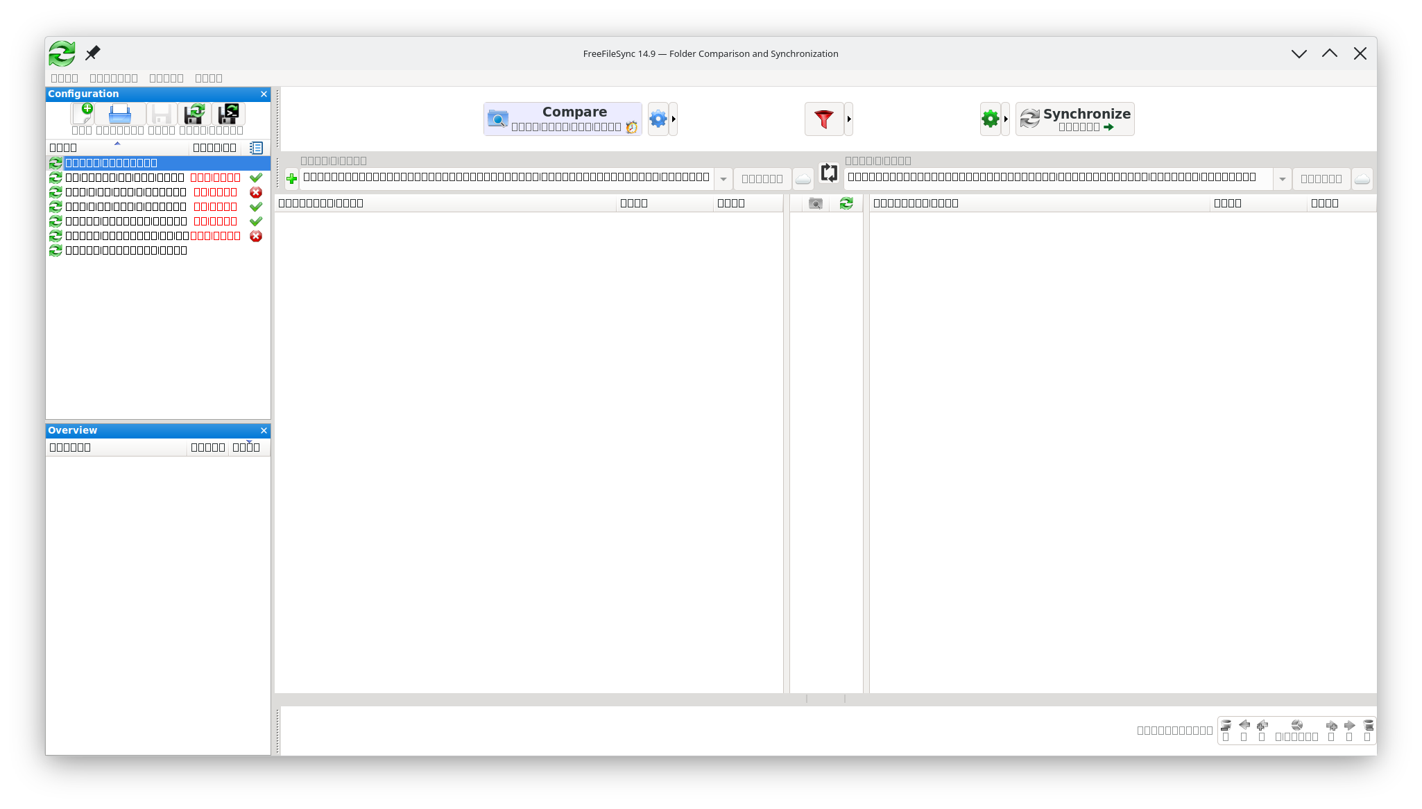

Right, ninja edit. Here it is, you’re all good:

This was my solution:
If everything is mounted properly, but you still do not see fonts in flatpak app - force font cache recreation inside flatpak container: flatpak run --command=fc-cache <application id> -f -v
I just had to add the app ID: org.freefilesync.FreeFileSync
I’m not sure if this fixed it either, but I added it to my config prior to running the previous command in this post:
fonts.fontDir.enable = true;
