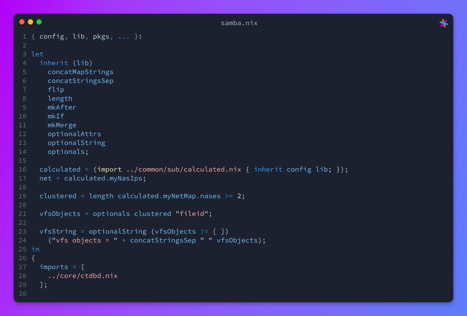

these some good examples here that may help you
and a pretty details configuration here.
