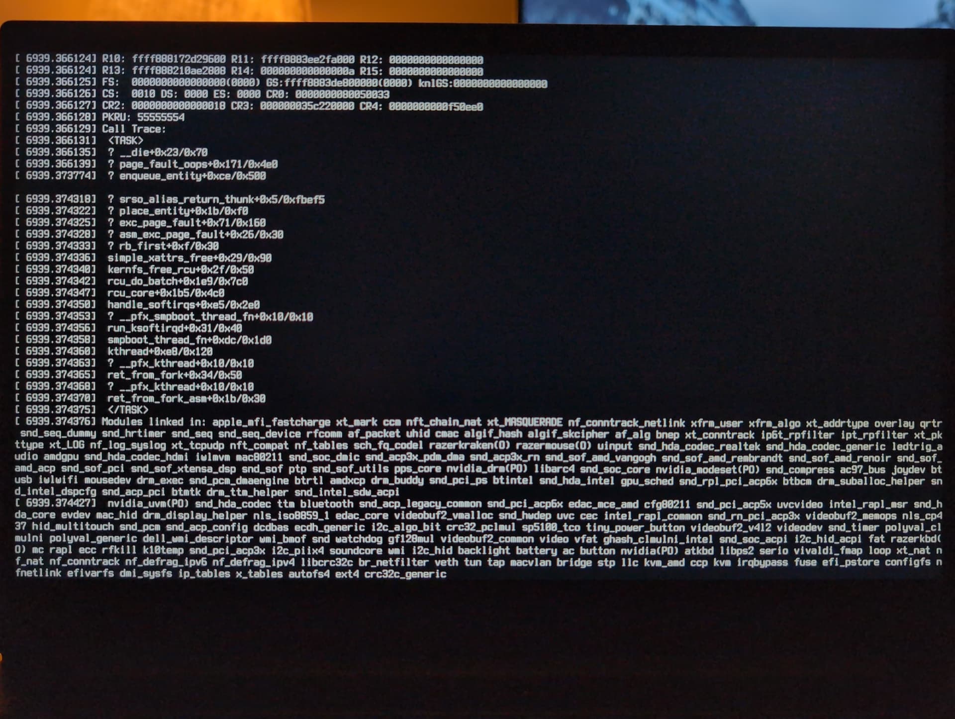

I have started to see a consistent output when I try to shutdown or restart. I no longer have any successful shutdown or restart attempts from Gnome or the terminal. I’m not totally sure how to get this in text form but here is a picture. I’m still very very stumped on this one.
Those are the last few lines of a kernel panic, I’m pretty sure. Any chance your caps lock is flashing?
That’d be why you need to force it off, as well, and could very well cause file system issues.
This could be any number of things, of course. I’ve had a faulty (internal) keyboard wire cause random panics before. For now, share a full journalctl --boot -1, and maybe try down/upgrading the kernel.
Wonderful. I can work with that. I’ll try and pin an older kernel. Haven’t done that in NixOS yet but I’m sure I can figure something out. My caps lock is not flashing, no.
