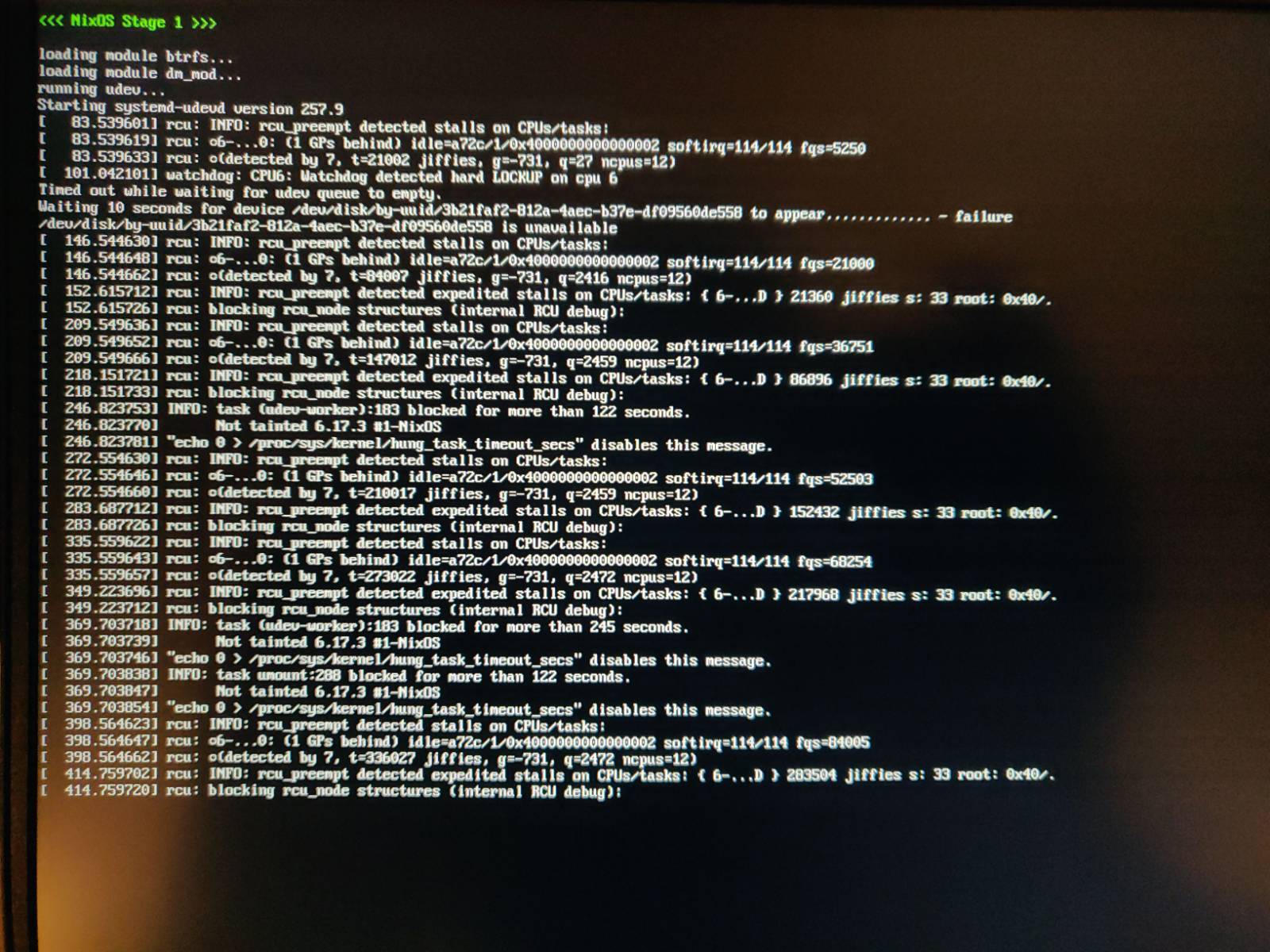

Nixos stage 1 error: /dev/disk/by-uuid/3b21faf2-812a-4aec-b37e-df09560de558 is unavailable
Hi!
This is my hardware config:

I put just for reference, because I didn’t change anything. I suspect that something may be wrong with either new kernel or systemd-udevd.service. However, this is my problem: when I restart my computer I get the following error:
/dev/disks/by-uuid/something_558 is unavailable… This is quite problematic because it is the main disk (NIX-ROOT).
What may be important is that I use disk encryption and it is formatted using btrfs.
Can you help me out? For now I have to use my older generation…

i would have expected that you were dropped into a recovery shell and could inspect the system… i think you might need to do that to figure out what is going on here… :thinking:
Well I didn’t I even tried to but I couldn’t type anything.
Once after about 10 minutes this device showed up and I could decrypt it.
Something very odd is going on, either with udev or with the kernel. You might want to bump up the log level. In the boot menu, press e to edit the cmdline, and change it have loglevel=7 and udev.log_level=debug

What is strange I can now normally boot but it takes a lot of time. After setting logs to higher level I got these:
I won’t even try to pretend that I understand any of them but what concerns me are these logs: Failed to remove source n/a (type io) from epoll, ignoring: Bad file descriptor (last line) and line 1759: Waiting 10 seconds for device /dev/disk/by-uuid/3b21faf2-812a-4aec-b37e-df09560de558 to appear....nvme0n1p3: /nix/store/qya2n1wigipsmki603fspjpdmszcx5h6-udev-rules/60-persistent-storage.rules:138 Added SYMLINK 'disk/by-uuid/3b21faf2-812a-4aec-b37e-df09560de558'. This is the line after which there used to be a “failure” and it refused to go on. Can you help me out further what these logs mean?
Somethings up with either the nvme kernel module or this 10000:e1:00.0 device. You see:
[Wed Oct 22 06:09:53 UTC 2025] 10000:e1:00.0: Running built-in command "kmod load"
[Wed Oct 22 06:09:53 UTC 2025] Loading module: pci:v00001E0Fd0000001Bsv00001E0Fsd0000001Bbc01sc08i02
Running this, we can see what kernel module that’s an alias for:
$ modinfo -F name pci:v00001E0Fd0000001Bsv00001E0Fsd0000001Bbc01sc08i02
nvme
And then a minute later:
[Wed Oct 22 06:10:52 UTC 2025] 10000:e1:00.0: Worker [231] processing SEQNUM=1978 is taking a long time
And then finally another minute later:
[Wed Oct 22 06:11:52 UTC 2025] Timed out while waiting for udev queue to empty.
[Wed Oct 22 06:11:56 UTC 2025] nvme0n1: Device is queued (SEQNUM=2039, ACTION=add)
[Wed Oct 22 06:11:56 UTC 2025] Inserted module 'nvme'
[Wed Oct 22 06:11:56 UTC 2025] 10000:e1:00.0: Device processed (SEQNUM=1978, ACTION=add)
So for some reason, the nvme module is taking barely over two minutes to load. That’s really weird.
