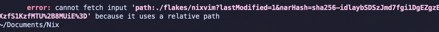

Worked on nix-darwin, just tried to apply it on NixOS and I think I hit what you’re referring to :frowning:
Then found this perculiar fix, and it worked…
Sow now, works on both, with:
my-nixvim = {
      url = "path:flakes/nixvim";
