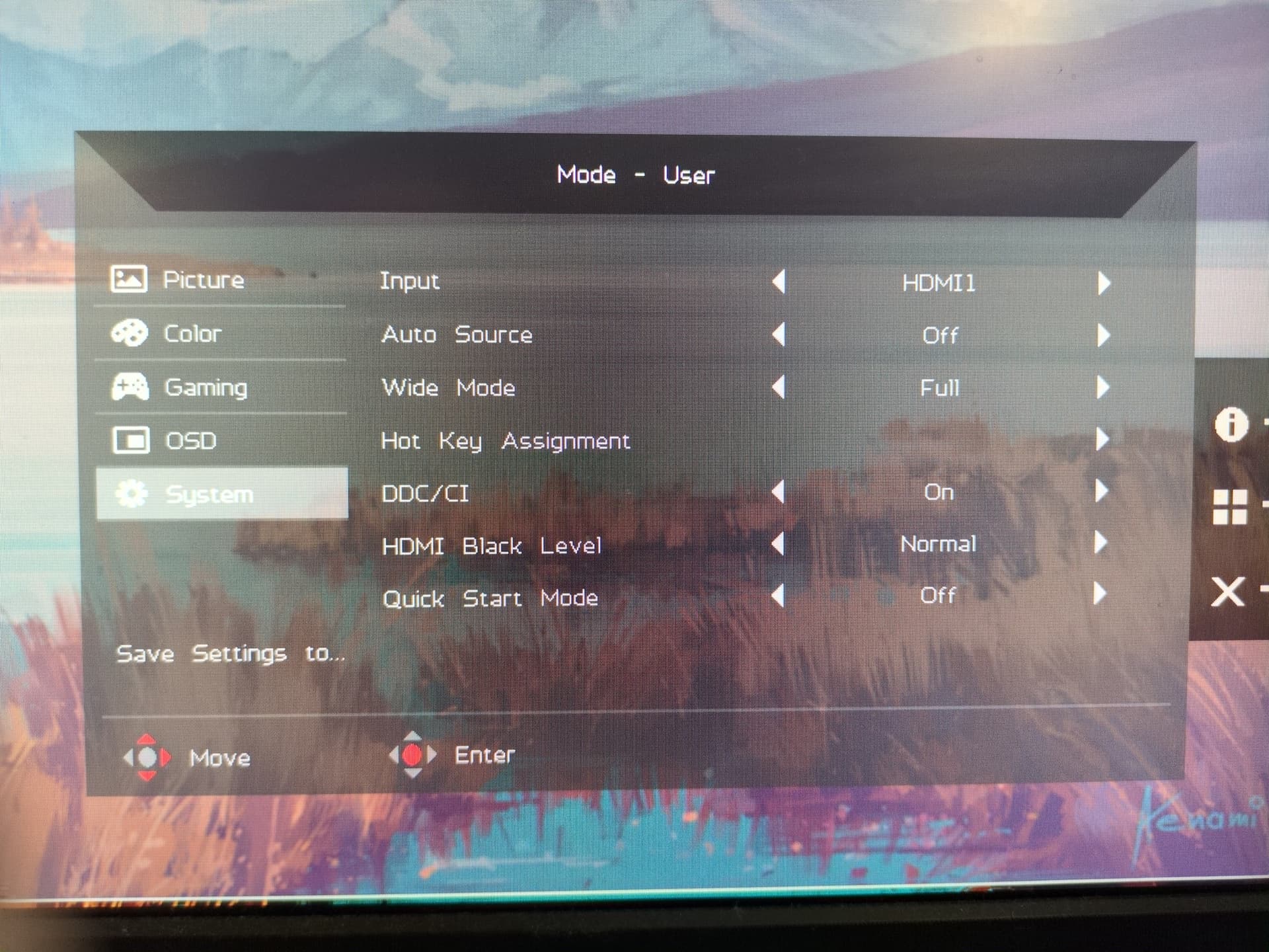

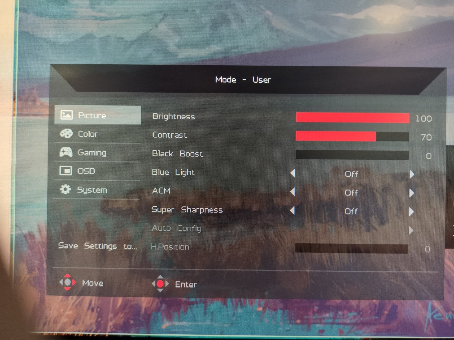

I think it’s the cable as well, I want to find myself one to test this. But it’s still weird how I was able to fix it on my other OS. The two monitors have the same settings, see below. I might try and get a DP to HDMI cable/adapter this weekend.
Ok seems fine. Can you try some options:
  1. Super Sharpness on
  2. Wide Mode what ever the other options there are
  3. DDC/CI off
If non of them show any kind of improvement turn them back to the original.
So I picked up a DP to HDMI adapter and used an HDMI cable I had, this fixed the problem. So it is either the DVI output port or one of the cables used (DVI - DVI, DVI - HDMI). Either way I am happy that worked. Thanks so much for trying to help me through this problem Postboote.
