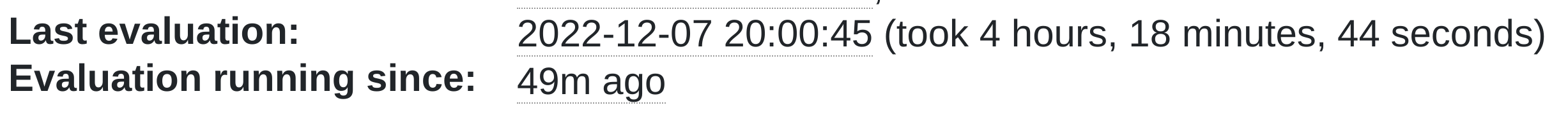

Optimize slow (4+ hour) evaluation
How do I approach optimizing an expression that takes a long time to evaluate? Is there any form of Nix profiler? Are there easy ways to experiment with techniques like memoization?
I mean this as a general issue but the expression that I am dealing with now is the hydraJobs attribute of flake github:lukego/nix-cl-report/ac1901afba8ca8501c12cfcd744b2ce0ae59a454.
This expression produces several thousand derivations that each reference large sets of build inputs. If I reduce the size of the build inputs then the expression evaluates much more quickly. I assume that a computation somewhere is being repeated.
I assume problems like this can be solved by strategically reusing/caching/memoizing values but it’s not clear to me how to identify which ones and to affect the caching.
EDIT: My problem turns out to be specific to Hydra evaluating expressions using hydra-eval-jobs processes (see discussion below.)

That is very interesting. This expression takes hours for me to evaluate on my Hydra server running on an otherwise-idle bare metal Intel server.
Maybe the slow performance is Hydra-specific then?

My ā€œevaluationā€ has been running for over one hour now. I don’t see any downloads in the Hydra logs (journalctl -f) as I usually would.
I do see a procession of hydra-eval-jobs processes using ~100% CPU and ~4GB RAM. Running ā€˜top’ the picture is consistent but there is a new pid on each refresh.
I wonder what’s going on? Is Hydra running a long series of sub-evaluations in separate processes before kicking of substitutions and builds?

I suspect the issue is that Hydra is evaluating job derivations separately and that this inhibits memoization.
I say this because running top on the Hydra server shows a series of short-lived (~1sec) hydra-eval-jobs processes running at maximum CPU.
It seems unfortunate if (a) these processes are repeating a lot of evaluation work already performed by the previous process and (b) running one-at-a-time despite the machine having many CPU cores.
