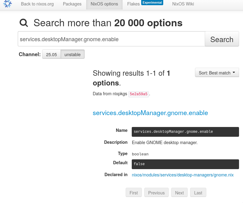

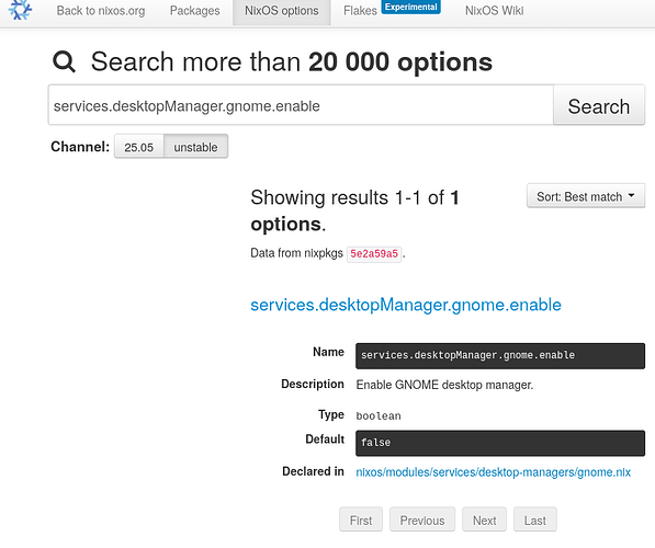

If you really want to know what an option does, one general option is to go to https://search.nixos.org/options, click on the options search (instead of package search) and click on where something is declared:
Doing this allows you to see things like:
services.system-config-printer.enable = (lib.mkIf config.services.printing.enable (mkDefault true));
which tells you that just enabling gnome will not enable printing. Instead, if you enable both gnome and printing, then the gnome system configuration for the printer will be enabled.
In practice, people will probably figure out that their printer isn’t working, go to the wiki page for printing, set the appropriate services.printing.enable = true; and move on with their lives, completely unaware that the gnome module was doing this magic in the background.
