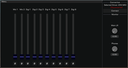

Any help would be greatly appreciated! As best I can tell, it looks like it’s getting hung up trying to download the imgui tarball specified in the source, but I can’t really tell why. My browser downloads it just fine when I paste the exact URL.
It looks like the package you are trying to build downloads things as part of its build process. The failure is at download-imgui_external.cmake.
Note that the items being fetched are not from the same upstream repository as the src.
Network access is not allowed in sandboxed builds, hence the errors.
The part of the upstream repository that this happens in is here.
Nixpkgs includes its own copy of imgui, so the build should[1] be configured to use it instead of fetching it as part of the make process.
  1. An exception to using nixpkgs version is if the upstream uses a different version and the project being packaged is not compatible with the nixpkgs version. ↩︎
This post might provide some insight Dealing with CMake FetchContent.
Excellent! Thank you so much for your help, this gives me a great direction to go in.
Seems like since it’s just imgui and a relatively recent version at that, I’m going to investigate patching the CMake list file such that I can provide the dependency in my derivation. Polygon’s work with Nix-Buildproxy is very impressive, but hopefully I won’t need that!
Usually I’m a teach-you-to-fish sort of person, but this was right in the sweet spot of ‘small enough to do while I wait for other things to compile’ but ‘fiddly enough that giving tips for all the little things to tweak would take considerably longer’, so here you go.

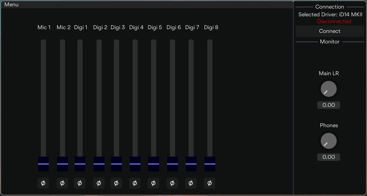

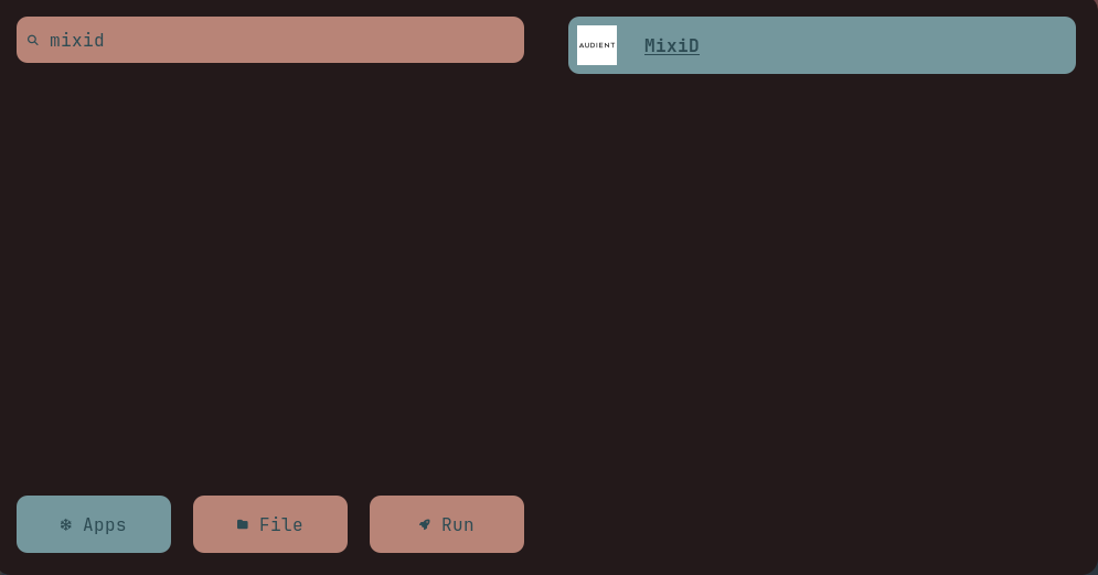

Well I’m not really sure how to begin to thank you because I feel like you’ve just simultaneously saved me like a week of fumbling my way through this but also taught me a lot at the same time. Thanks so much!
I hate to be the guy to come back with more basic questions after all the help I’ve received here, but does anyone have any pointers or best practices on actually getting this thing into my NixOS config? I don’t think it makes a whole lot of sense to do a PR on nixpkgs for it, but I’m struggling with some errors when I try to install from my local repo. I’ve tried several ways of doing this, and this seems to be the closest I’ve gotten (this is a NixOS module I made using my standard module template, I have roles.desktop.addons.audient turned on in my host config file):

Well it was a bit of an undertaking to get it sorted out, but now I have an overlay and a custom package installed on my machine. Thanks for your help!
Now my last question: does anyone know why rofi doesn’t seem to recognize MixiD as an application? I can run it just fine from a console command or from rofi as a command, but it doesn’t return anything when I try to search for it as an application.
Is this something in my derivation that I need to add, or would this more likely be something in my rofi config?
This probably because rofi searches for desktop entry files and can’t find one for MixID. This is part of the XDG spec and is stored in $XDG_CONFIG_HOME/applications/<program>.desktop or part of a derivation in $out/share/applications/<program>.desktop. The file for vim, for example, would be something like this:

I think you’re correct, but I’m still having trouble figuring out where to put this file. I don’t seem to have a ~/.config/applications directory at all, which is kind of weird. In any case, I’ve edited the installPhase of my derivation such that it includes the .desktop file, but I’m pretty sure I have the syntax wrong?
  installPhase = ''
    runHook preInstall
    install -Dt "$out/bin" MixiD
    install -t "$out/share/applications/MixiD.desktop"

Notice that we don’t have an icon for MixiD (there isn’t one in the repo) so we can’t configure one in the desktop file. Because of that, Rofi won’t show one for it, though it will show a name. You may try to use a generic one and it will have to be part of the derivation directory and be properly referenced or use fetchUrl for remote content (see here).
The cleanest way to add a custom desktop item is:
nativeBuildInputs = [ copyDesktopItems ];
desktopItems = [
    (makeDesktopItem {
      <contents with camelCase attr names>
Don’t forget to add copyDesktopItems to nativeBuildInputs, though. That hook is what interprets the desktopItems attribute.
Thanks so much! This has been great, and I really appreciate everyone who helped. I’ve learned a lot, and my NixOS config is better for it.
Not sure I’ll keep this icon, but it’ll do as a placeholder.
